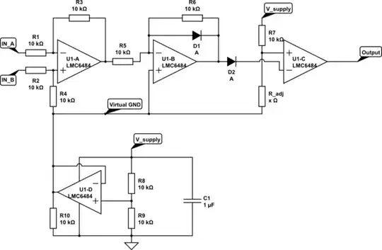

A single chip that would be enough to do this would be a multi-opamp IC; no matter what you'd do, you'd need external components to set the threshold difference, so there's nothing you can do about that.
If there was the perfect component for your use case, you'd still need to components – your super-funky specialized IC and some external resistor or so to set the threshold voltage, plus a decoupling capacitor for the power supply.
I propose the following, naive, circuit, which does what the others recommend, and only uses five discrete components (instead of the 2 you'd need with your specialized IC):
schematic
Now, you'll say, you count
  • four opamps,
  • ten resistors,
  • two diodes and
  • 1 decoupling capacitor.
Let me address this later. First a bit of functionality:
  • U1-A, R1–R4: Classical Difference Amplifier, unity gain; output hence IN_B-IN_A
  • U1-B, R5, R6, D1, D2: classical "precision rectifier"
  • U1-C, R7, R_adj: Comparator; voltage divider sets the threshold
  • U1-D, R8-R10: Constant Voltage source for the virtual ground; R8--R9 sets the virtual ground / reference voltage to V_supply/2; R10 is used to load the output slightly, as to avoid undampened oscillations.
As said, these are actually but 5 components in total:
  • U1-A–U1-D: It's absolutely common to find quad-opamps. The LMC6484 is a popular rail-to-rail choice. Since I assume you don't plan on adding a second supply, we'll need a virtual ground.
  • R1–R10: There's resistor arrays you can buy that just contain the same resistor multiple times in a single package. Easy to pick, place and solder.
  • R_adj: at some point, you need to set the threshold voltage.
  • D1 & D2: there's three-pin dual-diode packages that have exactly one pin connected to the cathode of one, and the anode of the other internal diode
  • C1: you don't get around decoupling your power supply. In fact, you should probably add one of these to the threshold voltage point (+ of U1-C) and to the center of the R8--R9 divider, too, but it'll definitely work without

  • Thanks, this is pretty creative in terms of component number, although I have to select Andy's one as the answer. – BeB00 Dec 02 '16 at 06:44

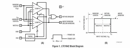

There is an oddball chip (LTC1042) that does exactly what you want- the manufacturer in fact calls it a "window comparator". It even has a ground-referenced high-Z input for the window half-width.
You can feed in one voltage into each input and a fixed voltage to determine the width of the comparison window, so at most 3 parts if you don't have a suitable reference voltage available.
It's not a high-speed device (~100usec response time).
Also keep in mind that, despite being shown as an active product, the fact it has not been migrated to an SMT package probably bodes ill for availability far into the future. On the plus side, it's been available for decades.
Spehro Pefhany

  • Thats some pretty good sleuthing, how did you find this out of interest? Unfortunately I wont be able to use it as it's too big, but it is exactly the right component. – BeB00 Dec 02 '16 at 06:41
  • I have designed this part into a product, some years ago. – Spehro Pefhany Dec 02 '16 at 06:42
