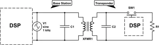

I'm trying to read a LF (low frequency) RFID transponder, it works in the following manner: It uses load modulation, the receiver (the base station) generates the carrier and the transponder modulates it using magnetic coupling (like a electrical transformer), the transponder (or tag) being read switches a load (resistance) and it changes the carrier's amplitude like can be seen schematic ilustrated below (but it is only an illustration, the circuit is a bit more complex).
schematic

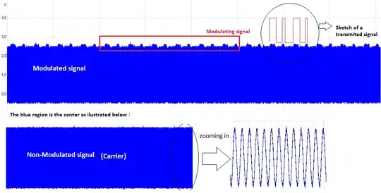

The generated signal was obtained by an oscilloscope and is presented in the following explicative picture:
The information being modulated, as can be seen, is very weak compared to carrier's amplitude. The carrier frequency is 125kHz and the base band signal has a 20kHz bandwidth.
