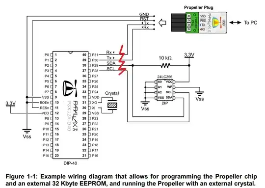

I am using a P8X32A (Parallax "Propeller" microcontroller) in many of my hobby projects. It has no NV RAM internally on the chip so it loads its program code from either a serial port TX/RX pins or from an I2C EEPROM (24LC256) on SDA/SCL pins. This loading is entirely handled by the silicon on the micro and cannot be altered.
It takes no more than about 2 seconds or so for the code loading process to complete, after which time those four pins become fully general purpose IO in the 4 MSBs of a 32bit GPIO port! That's a pretty great feature, but it does mean I need to treat those 4 pins as a special case, which is not ideal.
  • From the P8X32A Manual v1.2 (page 17). The jagged red line indicates the 4 signals I want to redirect after booting has completed. enter image description here
For a future project I'm planning I would like to use all 32 pins of this GPIO port for high speed IO but I do not want to still have the top 4 pins connected to the serial port or the I2C bus.

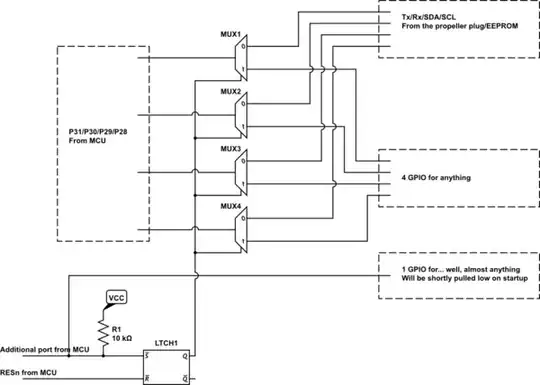

Here is my suggestion (hope it makes sense):
We have a quad 2-to-1 multiplexer to toggle the signals, as you suggested. A RS latch is used to decide the routing of the multiplexers. On MCU reset, the latch output routes the signals to the "startup" destination (plug/EEPROM). Now, the trick would be to use a fifth port of the MCU to switch from the startup state to the normal state, as soon as your program starts.
schematic
Of course, you'll say: "but then one of my port is dedicated to this task, so I can't use it anymore! I want to be able to use all my ports!" (yes, you'll say that, I can even hear you from where I am).
Well, the thing is, once you are in the normal state, this signal has no effect anymore on the latch (until it is reset, of course). So you can actually use it for anything else at this point. The only drawback is that this signal will be toggled from high to low at startup (you can toggle it back high after). I'm sure you can find a signal in your application that can tolerate this behavior (a LED output, or anything not critical).

  • Yep, you did literally read my mind :) Your method does look very neat and tidy though, despite the rogue pulse being necessary. Hmm, it's almost like I need a 2-bit shift register to conceal the first pulse from the rest of the circuit. I shall consider this. –  Nov 25 '16 at 19:35
  • The problem with a shift register is that it will delay your signal, even once you switch to normal mode. And what do you feed as the clock, what do you feed at the data input of the shift register? Maybe, instead, to swallow the initial pulse we could imagine a scheme with a D flip flop rather than a RS latch, but before switching my brains back on, I'd like to confirm that, really, there is no GPIO that could tolerate this glitch. What is the use for these 32 GPIO, exactly? – dim Nov 25 '16 at 20:27
  • Long I have had in my mind the desire to create a high frequency, low voltage signal generator, with the ability to become a logic analyser by changing the firmware. Now my specific requirements are extremely narrow and specialised and very likely not really useful to anyone else. As such it woud basically be a piece of test gear and it would be rather nice to avoid sending that rogue pulse to the "device under test". However this SE question need not concern itself with my specific plans because (as you have demonstrated) Propeller users sometimes want to use ALL their IO :) –  Nov 25 '16 at 20:34
  • Ok, I understand. Well, I was just asking so that I can have an idea of where the compromises can be made, eventually. But actually, solving this isn't that easy, then. I'm afraid complexity would make it not worth it. I'm not familiar with propeller, but maybe it would actually be simpler to pick a device with more GPIO, if it exists. – dim Nov 25 '16 at 21:06
