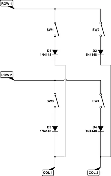

Let me illustrate with an example similar to what you presented, using four switches, but done correctly:
schematic
It should look more like that. Note that the diodes don't form a conductive path that proceeds through more than one of them at a time.
