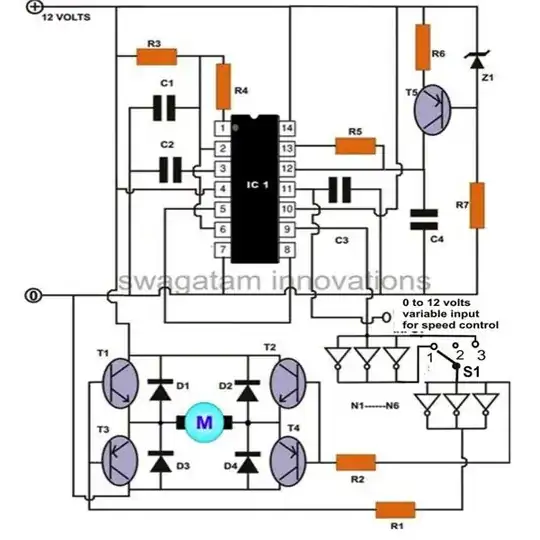

I'm trying to build a dc motor controller circuit as described here.
But it requires 2 "150E" resistors
From looking online I believe this means 15 ohms but I'm curious as to why, and why I couldn't find anywhere explaining such.

E means ohms. 150E is 150 ohm.

  • No it doesn't. E most likely stands for an E series resistor e.g. E24 - preferred value resistor see http://www.resistorguide.com/resistor-values/ – JIm Dearden Nov 21 '16 at 13:11
    E24, yes. 150E on the other hand means 150 ohm. There is no E150 series. – winny Nov 21 '16 at 13:12
    I stand corrected - you can get a 2E2 resistor (2.2 ohms) so +1 – JIm Dearden Nov 21 '16 at 13:18
