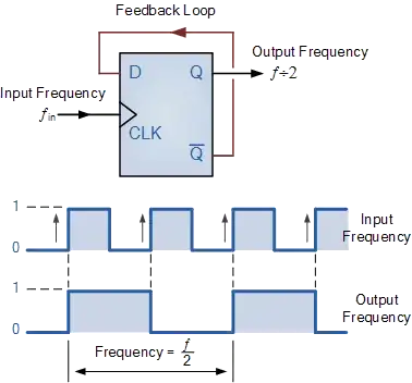

I would like to simulate a simple one-bit counter (or frequency divider) using the D-flip flop.
1-bit counter / frequency divider
However, I don't want to use the abstracted D-flip flop above. Rather, I want to simulate this using primitive NOR/AND gates directly. I rigged up a D-flip flop based on NOR Gates below.
The full simulation can be seen at this link: http://tinyurl.com/z6mae9c
However, I cannot connect the Q' output back into the "D" input without getting an error (endpoints circled in red below). Can anyone recommend how to fix this? Is this a limitation of the simulation framework? If so, what's a good package to simulate this on?

It cant work as you expected, but I fixed the simulation
Difference between latch and flip-flop?
Tony Stewart EE75
  • 54
  • 185
  • Thanks a lot Tony, the link was very helpful! I was able to finally construct a working frequency divider using the master/slave flip flop design: http://www.falstad.com/circuit/e-masterslaveff.html – Ismail Degani Nov 18 '16 at 07:47
