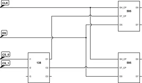

I am trying to multiplex several SPI devices using a 74HC138 3-to-8 multiplexer. My program logic changed from typical "set CS low, SPI out, set CS high" to something like:

This would make sense, but seems to directly contradict with the 74HC595 shift register behaviour for low->high ST_CP (so my CS) pin transition:
contents of shift register stages (internal QnS) are transferred to the storage register and parallel output stages
The behaviour table and functional diagram basically state that ST_CP is irrelevant when the data comes in on SH_CP/DS, and it will be stored in the shift register. That would mean that if I write some data to other devices, and then briefly toggle the ST_CP pin, I'll write this garbage out! (assuming output always enabled).
As I see it, this is precisely what my selection code is doing, because the bits don't actually flip immediately; the multiplexer will go through other pins. Does that mean I need a separate pin to disable (make high) all of the mux outputs during the switching? Am I understanding this correctly?

  • A full schematic would help. For example, are you tying the '595's STCP and SHCP signals together? Are you sharing those lines with chip select for the SPI devices? Etc. – The Photon Nov 16 '16 at 16:50
  • @ThePhoton No, the SHCP is connected to the clock line of the SPI "bus", and the STCP is connected to one of the outputs of the 138. So the 138 acts as the CS selector. But based on the answers, I think simply making the 138 get all pins high and then only getting the desired device low should fix my problems with wrong CS being momentarily toggled. – Bartek Banachewicz Nov 16 '16 at 17:40
  • @ThePhoton I've added the schematic to try out the circuit editor :) – Bartek Banachewicz Nov 16 '16 at 17:54
Yes.
If the 138 is permanently enabled then it will respond to intermediate codes that may occur as you set each of the three mux bits. In other words it will 'glitch' outputs that you didn't want.
The 138 has three enable inputs which must be made active (/E1,/E2 = low, E3 = high) to enable the decoded output. You should control one of these enable inputs so that while setting the device number the 138 is disabled, causing all outputs to stay high. After setting the device number you can enable and disable the 138 to pulse the decoded output.
