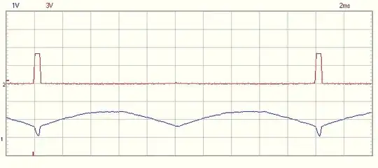

However if I hook up my scope then I get the following image:
You can see that ther is only 1 zero cross detected while there should be 2. Can someone explain why this happens?

When a 10kOhm resistor is applied at the output of the bridged rectifier: enter image description here

    Try putting 10 kohm to 100 kohm across output of bridge rectifier. – Andy aka Nov 15 '16 at 15:58
  • The output of the bridge doesn't really drop to zero Volts. Your scope picture shows it a good bit above zero. When it is too high, then the transistor base is high enough to still conduct. That 10kOhm that Andy mentions will bring the bridge output down lower so that the transistor can shut off. – JRE Nov 15 '16 at 16:02
  • When you connectecd the 10kohm load you turned your bridge rectifier in a half wave rectifier.
    That means your circuit ground connection (BJT emitter) is actually earthed somewhere (maybe in the PSU). This is a very good thing to your safety but unfortunately toghether with the earthed mains neutral wire just shorts out a half of the diode bridge.
    – carloc Nov 15 '16 at 17:31

The basic problem is that your AC source is not-isolated from ground. If it were then there would be no problem when you add the 10 kohm resistor that I recommended.
So, you have one incoming AC line close to earth potential and on the DC side of the bridge you are connecting one side down to earth and this turns the full wave rectifier into a half wave rectifier and you are just seeing the rectified positive half cycles when the non-earthed AC line rises positively.

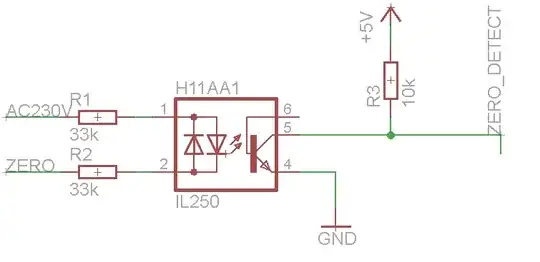

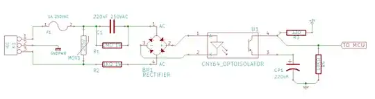

This circuit only will work when there is galvanic isolation between input AC and earth. I would also recommend that you need isolation for safety reasons so, maybe use an opto-isolator solution. Here are a couple of ideas: -

    +1 For promoting opto isolation. The unisolated voltage and zerocrossing detectors are a accident waiting to happen in all cases when the complete circuit is NOT totally independant and isolated from everything else. Any other PSU, scope, laptop, person may cause ground faults of various sizes. – KalleMP Nov 15 '16 at 19:49

The missing pulse is due to insufficient Dc load and some stray effects.
Put a load R of 22k to 47k or so across the Dc side of bridge. to make a 20:1 divider. Without this when the transistor base of off, there is no resistance but some stray capacitance. If you intend to power off same bridge adding a cap will cause both pulses to be missed, then you need a different circuit. see link below.

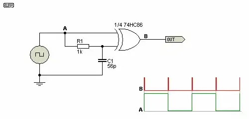

A better way is ac couple a reduced voltage to 3Vpp and drive a self biased gate to make a square wave then use an XOR with delay on one side to produce the pulse for each crossing at any width you need with RC delayed clock compared with clock to get _ | _ | _ | _ | _
https://sound-au.com/appnotes/an005-f1.gif

You have nothing actively driving the base of Q1 low during the rather short time the full wave bridge output is near zero. Even stray capacitance on the rectified signal apparently keeps it high long enough so that the transistor doesn't turn off.
To fix this, add a resistor between the base and emitter of Q1. It's not clear what voltage is coming out of BR1, but 10 kΩ B-E will probably do it. That not only will actively turn off the transistor a little, but is also increases the threshold of the BR1 output signal where it is considered "zero".
Added
You have added a 10 kΩ resistor on the output of BR1. Now the zero detect signal is more of a square wave.
Looking at the BR1 output signal we can see why, which is that one of the two half-cycles is missing. This means at least one of the diodes that should conduct that half-cycle is open. Since the four diodes are integrated into a single unit, you have to replace the full wave bridge. If you don't have another one, then you can make one from four diodes. Make sure they are rated for the full peak to peak AC voltage, plus some margin.
Another possibility is that the AC source you show is not really floating as you show. If it is the power line, then it is ground-referenced. That's not going to work as you seem to intend if your circuit is also ground-referenced.

    @mai: In that case I'd use two parallel opto-isolators that produce a square wave. The edges will be close to the AC line zero crossings. You are running into trouble, and safety issues, but directly connecting the controller and the AC line. – Olin Lathrop Nov 15 '16 at 19:36
