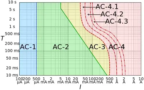

A perceptible shock suggests that you actually experienced >500 µA for at least 10 ms.
The human body for ESD has 100 pF in parallel with a resistance ranging from 1.5 kΩ to 100 kΩ. If your skin is damp or broken, it's much lower. When receiving a shock at 60 Hz, the capacitance is equivalent to the ~26 MΩ impedance in parallel with <100 kΩ resistance. So we have two parallel impedances, one much smaller than the other – so capacitance is negligible for a 60 Hz shock (unless the shock is very high frequency or impulse-like).
Using 100 kΩ, you experienced ~1.2 mA of current depending what part of the 60 Hz was in effect, inside the AC-2 (perceptible) region.
Diagram of electric shocks as experienced by humans
Electric shocks kill when your resistance is much lower or when the path of least resistance includes your heart. If your resistance was 1.5 kΩ the shock would be 80 mA, potentially fatal if it lasted long enough.
