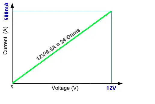

You must also consider the current vs voltage characteristics of your load. If it acts like a pure resistor then it looks like this:-
If the power source is connected directly to the load then their voltages and currents must be the same, so we can combine the two graphs to find the operating point:-
So connecting one of your panels to a purely resistive load which draws 0.5A at 12V would result in about 23mA at 0.55V.
