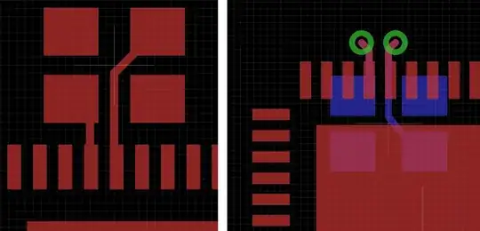

To avoid to use very small and expensive crystals I'd like to use a bigger one and place it to opposide side of PCB to save space.
My question is: Is it possible to place an SMD oscillator on opposite side and connect it through vias?
In my case I've a 4 layer PCB. I'd like to know if this will harm or affect crystal signal quality and if it's used/unused practice.
Here's an example image: enter image description here
EDIT: In this example and in my question I refer to a crystal (no oscillator). I've not placed capacitors to have a more clear example. EPSON TSX-3225 38.4000MF10Z-AS3 is a device that I'd like to use.

  • I do not think you would want to put the crystal exactly there on the other side of the PCB. Depending on the number of layers, it could create some type of signal interference between traces. – 12Lappie Nov 08 '16 at 18:47
    Don't worry, it will work. But where are the capacitors –  Nov 08 '16 at 18:47
  • As far as I know, it is recommended to place the oscillator on the same side and as close as possible. See this post – Nazar Nov 08 '16 at 18:51
    @GregoryKornblum I think this is one of those oscillator ICs that require only a decoupling capacitor on the power rail. – user110971 Nov 08 '16 at 18:58
  • @12Lapointep It's four layer, so it should be fine, as long as you have power planes in the inner layers. – user110971 Nov 08 '16 at 18:59
    If it's an oscillator, why there are two traces connecting to the IC? What is the PN? –  Nov 08 '16 at 19:01
  • This does not work as a generic question with unknown frequency and other details. In many cases, there would be no issue at all placing a crystal on the other side of the board. But in some cases it could result in complete failure. More careful analysis of missing details would be necessary to suggest a reliable response. – Richard Crowley Nov 08 '16 at 19:29
  • The OP should clear his question and make a choice whether he asks about crystal, or oscillator. Crystals typically require certain specified capacitance load to work properly, while oscillators don't need them. – Ale..chenski Nov 08 '16 at 19:32
  • I have a suggestion: use through-hole crystal. I used one in my design, HS-49S, with central grounding pin. This way your via will become a pad, and you can mount crystal at any side. – Anonymous Nov 08 '16 at 19:45
  • I'm sorry if I was not clear, I've edited my question. – Singee Nov 09 '16 at 10:42
You can do that, as long the frequency is not too high. A few 10's of MHz should be fine. As always, if the frequency is high, you should consider the signal integrity. The vias introduce impedance discontinuities, which can make the clock non-monotonic from the reflections. This is a problem, if you do not have a Schmidt trigger inputs.

  • "With a few 10's of MHz" do you think 50Mhz it's enough slow? – Singee Nov 09 '16 at 10:45
  • @Singee depends I guess. Is it a square wave oscillator? 50Mhz has a period of 20ns. Probably a rise time of 1ns. This gives $0.35 / f_{\mathrm{rise}} = 350 \mathrm{MHz}$ bandwidth. I would be a bit concerned at those frequencies. You can try putting it in spice by calculating the transmission lines. You have trace -> via (PCB thickness) -> trace. – user110971 Nov 09 '16 at 10:54
  • Unfortunately rise time is not specified on datasheet of p.n. that I've added to my question. Maybe on oscillator/mems it's specified but on crystals I've never found this information (suppose they've a sinusoidal wave) – Singee Nov 09 '16 at 11:04
  • @Singee it depends on the type of oscillator for the IC. At this point I would build a prototype to see if it works. Or you could do single integrity simulations, if you have the tools. – user110971 Nov 09 '16 at 11:09
