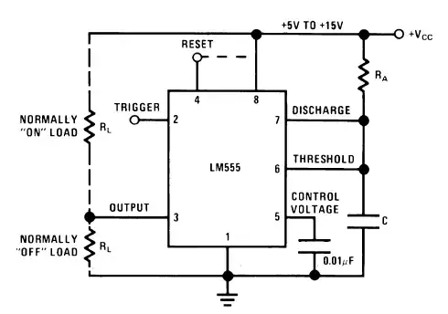

What you need is a monostable multivibrator or MMV. The MMV is a typical application for the versatile LM555 timer. The schematic below is taken from the datasheet, page 8.
\$ T_{PULSE} = 1.1 \cdot R_A \cdot C \$
Falstad Simulation

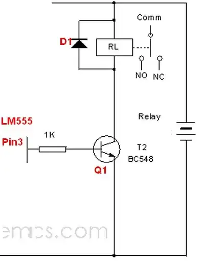

The circuit shown above produces a high level out equal to the power supply voltage when "triggered".
To operate any other device an easy method is to use a relay.
There are other methods but a relay provides isolation and allows any voltage and current that the relay is rated to handle to be switched. This circuit connects to pin 3 as shown above and operates the relay when the 555 is triggered.
The relay contacts can be connected as required. The relay needs to be able to operate from the supply used and the contacts must be rated to handle the load and voltage used.
Q1 = as shown or suited to relay used.
D1 = 1N400x.
