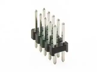

Headers are pretty cheap and make a lot of sense over a wide range of quantities, down to 1 piece. A 5 x 2 header takes up very little space, even less in 2mm pitch. The connections usually end up free of flux so they don't crud up the mating connector.

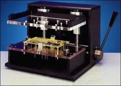

For really high volume, you can use a fixture with spring-loaded 'pogo' pins which can be cheaper per unit, but the fixture has to be designed and manufactured. The below is one size of pogo pin, illustrating a few types of ends. Some are designed to contact 'dots' on the PCB, some to go into holes and some to contact the wire soldered through a through-hole. See this answer for more info.
One advantage of the pogo pins is that you don't need to bring all the connections to one small area- you can put probe points anywhere on the board, and sometimes outside the finished board on the tooling strips or other sacrificial bits of PCB.
You can get pre-wired sockets for the pogo pins which makes it really easy to maintain the fixture- when the pin gets crudded up or breaks or wears out, just plug in a new one of the correct type.
Example fixture from here using kit parts plus some custom bits made for the board. See also the sparkfun tutorial that @Brendan linked to in the comments for budget approaches useful for small boards.

The simplest method is to use a 10x1 or 2x5 through-hole header on the board, then don't populate the header. This leaves plated holes on the board into which a test connector can be placed but not soldered. I do this frequently when I have enough real estate for the connector. Sometimes you may need to apply some sideways force to the connector to get all 10 pins to make electrical contact.
During initial system bring-up and debug I tend to solder the connector to the board. During production it is usually enough to hold the connector to the board and select the "TEST" or "PROGRAM" button on the PC application.
  • It also helps if you slightly offset the holes from their normal pitch, so that a pin header can still be inserted, but the friction will hold it in the board during test. – Brendan Simpson Nov 03 '16 at 19:23
  • @BrendanSimpson Yep! More precisely, offsetting every other hole horizontally so the connector has to "wiggle" a little. I've seen this trick for factory programming headers on some of Digilent's FPGA development boards. –  Nov 03 '16 at 19:39
