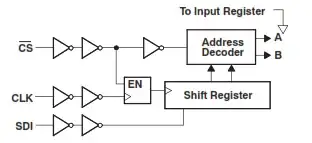

In the datasheet for the DAC8812, there is this diagram in Figure 33:
What is the point of drawing cascading inverting buffers when, logically, it's the same as a single non-inverting buffer? This isn't the only place I've seen it.

    I reckon that's a more physical description of what's going on, rather than the logical version you appear to want. That means it's been drawn by the chip designers, rather than by the customer-facing applications engineers. Much the same as my wife and I will go to look at a new car, I'll be asking whether it's 2 or 4 valve per cylinder, and she wants to know what colours are available. – Neil_UK Nov 01 '16 at 21:12
  • @IgnacioVazquez-Abrams - your accepted answer to that question doesn't really explain this one since this one doesn't use the 'intermediate' inverted signals – brhans Nov 01 '16 at 21:12
  • Should be indication of (a) internally buffered signal and (b) internal delay? Two NOT gates are implemented as buffer (as I recall NOT+NOT in series is the right way to implement non-inverted buffered signal) – Anonymous Nov 01 '16 at 21:15
    Possibly because you can't get inverting and non-inverting buffers in the same package, so it assumes you're using one chipload of buffers; since the circuit needs one inverter, they drew the rest of the buffers as the same type? – Ian Bland Nov 01 '16 at 21:20
  • Cascaded inverters are so commonly used in HCMOS gates that it is considered the norm. For example, a single (one-of-six)74HC04 inverter consists of three cascaded inverters. However, a 74HCU04 is the special case of a single-gate inverter (often used in oscillators). Some lazy chip-makers don't bother stating that their logic is "buffered" - meaning that they're using cascaded gates. – glen_geek Nov 01 '16 at 21:21
There is no reason to do this, other than the picture was drawn by some technical writer from a gate design documentation provided by a designer. The reason is that there is no such thing as non-inverting buffer, a pair of basic CMOS transistors forms an inverting circuit, so an non-inverting function must be made out of two inverting gates in sequence.
