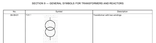

In IEC-land (Europe and the Commonwealth), two overlapping circles usually means an (AC) transformer.
From Australian Standard AS 1102.106 Graphical symbols for electrotechnical documentation - Part 106: Production and conversion of electrical energy:

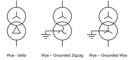

Where the transformer is a three-phase type, there are often some extra qualifying symbols added which denote the vector groups of the windings.
