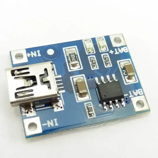

Since this phone battery is a Li-Ion battery, the only safe way to charge such a battery is by using a LiIon battery charger circuit.
You can buy a ready made module on ebay for this, they're cheap only $ 1.50 or so.
If you try to charge the battery in any other way you risk overheating, damage, smoke and fire.

  • Thanks! I will get this one, but my question is how to do this without using any external modules. I want to learn how the charging exactly works and get it to charge using my own micro-controller. If I understand how the process works, I can build my own circuit, unless it uses some black magic parts I can't get in a regular electronics store. Can you please point me to the right direction? – 0x29a Oct 20 '16 at 12:19
    I would agree if the circuit you provided were able to read the thermistor, but it only provides two output contacts, therefore it's just a fixed voltage power supply. Any power supply capable of providing a regulated and accurate voltage of 4.1V would be fine and as safe as the one you showed. If you want real safety, you should use a circuit capable of reading back the thermistor, but it's not the one of the photo. – FarO Oct 20 '16 at 12:20
    @OlafM You only need the thermistor (or temperature feedback) if you want to charge the battery quickly. For slow charging at 0.2 C for example, temperature feedback is not needed. This module is intended for slow charging. – Bimpelrekkie Oct 20 '16 at 12:34
    @0x29a You want to learn, excellent ! Then get reading, learn how a LiIon cell must be treated at Battery University: http://batteryuniversity.com Then see how charger chips work, like the TP4056 in the module above. Basically you need voltage and current limiting. You will need some extra components besides the microcontroller to do this. That in total will not be smaller than that module. – Bimpelrekkie Oct 20 '16 at 12:39
  • @FakeMoustache then why do you suggest it as 'only safe way' if it does exactly the same thing as a fixed voltage power supply I can easily do at home? I would end up waiting for a month to get these from china when in reality I can get this working today with the right guidance. I asked a very simple question and I'm sure the answer doesn't involve digging as deep as 'battery university'. – 0x29a Oct 20 '16 at 12:45
    That module is not just a fixed voltage source. Li-Ion batteries are only safe if you treat them correctly. That's why this phone battery will have a protection circuit. But it does not provide 100% safety (not idiot proof). If you have a lab supply with adjustable current limit then you can safely charge this battery, use 4.1 V and 100 mA and you're good to go. Ask Samsung about their Note 7 and if they think Li-Ion batteries are always safe. – Bimpelrekkie Oct 20 '16 at 12:49
