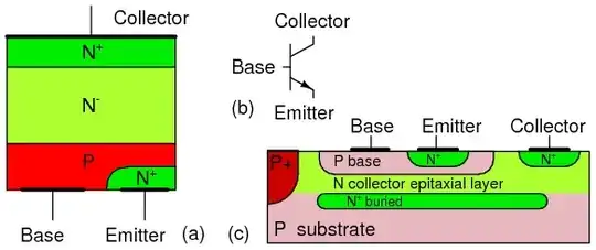

BJT transistors today are also made in MOS-like technology, which means 'etched' on a surface, but basically they consist in three layers of semiconductor differently doped, so they are primarily meant for discrete technology. In fact, the way they are now built is creating these three layers at different depths in the silicon, and (just to give an idea), in recent technology they occupy an area in the squared micrometer order or so, while MOS transistors can be built in <20 nm technology (update this value regularly), with an overall area that can be in the order of about less than 100 nm². (picture in the right)
http://openbookproject.net/electricCircuits/Semi/SEMI_2.html
So you can see that, added to the other properties, a MOSFET transistor is much better suited (in today's technology) to achieve Very Large Scale Integration, or VLSI.
Anyway, bipolar transistor are still widely used in analog electronics, for their better linearity properties. Also, a BJT is faster than a MOSFET built with the same technology (meant as transistor dimensions).
