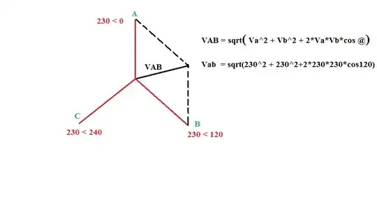

I know that that in 3phase ac, Vll = sqrt(3) * Vln
I got confused about the sqrt(3) part so I draw phaser diagram and the resultant vector will give me the phase -phase voltage
But it only gives me 230V , why? Can anyone explain how it got sqrt(3) in equation??

What you are calculating (the black line) isn't actually \$V_{AB}\$, it is rather the vector sum of \$V_{AN}\$ and \$V_{BN}\$ which is actually just \$-V_{CN}\$.
\$V_{AB}\$ is the voltage of \$V_A\$ referenced to \$V_B\$. To calculate that, you have to subtract one from the other. So the vector sum is actually:
$$V_{AB} = V_{AN} - V_{BN}$$
Doing the calculation, we get:
$$\begin{align}\\ V_{AB} = V_{AN} - V_{BN} &= 230\angle0^\circ - 230\angle120^\circ\\ &=398\angle30^\circ\\ &=(230\sqrt{3})\angle30^\circ\\ \end{align}$$

Notice how the calculation you did (left) and the correct form (right) differ. You can see from the diagram that the line drawn for \$V_{AB}\$ is actually equal to the vector that takes us from the point \$V_B\$ to \$V_N\$ (-\$V_{BN}\$), and then from \$V_N\$ to \$V_A\$ (\$V_{AN}\$).
