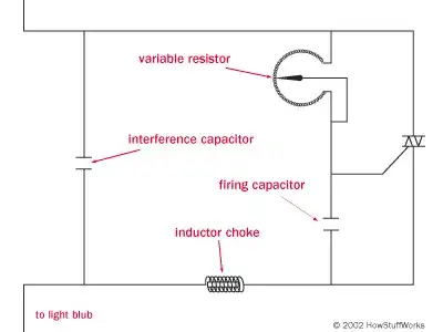

I'm familiar with simple forward phase dimming using a triac. The circuit is stupid easy with only a handful of components. enter image description here
Of course this simple example can be improved upon to make it safer or improve performance and efficiency. But the basic principles remain the same.

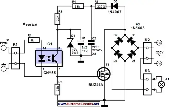

A reverse phase dimmer does not have a triac but an IGBT or MOSFET. Such a dimmer contains also the electronics needed to modulate this device. These electronics can be simple or very complex.
The principle is simple. The mains AC is fed into a bridge rectifier with in the centre the IGBT or MOSFET. The IGBT or MOSFET can be switched on and off at any moment. The AC can be triggered on the leading edge, The trailing edge or somewhere in between and for the duration needed.
This makes such a dimmer suitable for: Halogen lamps Standard incandescent lamps Electronic mains LED lamps of different kind. etc.
If the dimmer needs with different kind of lamps then the control system has several settings to make that possible. In case of remote control the dimmer can become expensive.
Using the principle with the bridge rectifier and the IGBT or MOSFET it would be possible to make yourself but I did not work that out. Maybe the schematic included helps. The dimmers are very sensitive to overload but since only the IGBT or MOSFET is destroyed also simple to repair.
Remark: The previous picture had some wrong earth connections so I have changed it. The incomming PWM circuit is isolated from the mains side. Thanks to Elektor.

    I think you need to remove the earth symbol on the right (bridge rectifier short-circuit) and remove the link between R3 and the earth on the left (you don't need it when you have the opto-isolator). See here for explanation of the rectifier problem. – Transistor Oct 10 '16 at 20:39
  • I've added a paragraph of some additional insights into my project. Based on your answer, I think the place where I need to focus my efforts is on the zero-cross detection. I believe that I can connect a PWM output on the PADI directly to the gate on a MOSFET and call the switch good. But making a zero-crossing circuit and connecting that to the PADI is where things get fuzzy. I found an article online that uses a 741 op amp for zero-cross detection. Maybe the PADI is sophisticated enough to take an unrectified v-in and I can do detection in firmware? At least this gives me a start. – Thomas Oct 10 '16 at 22:38
  • @Transistor: The drawing was not mine. I have changed it. – Decapod Oct 11 '16 at 01:37
  • @Decapod: That's better and safer. You should credit Elektor magazine with that schematic. It is immediately recognisable as their house style. – Transistor Oct 11 '16 at 01:40
    @Thomas: "I believe that I can connect a PWM output on the PADI directly to the gate on a MOSFET ..." Be very careful with your beliefs. Isolate if at all possible as shown in the Elektor schematic. It prevents you getting high voltages on your micro and makes debugging much simpler. You should ensure good separation between the control and mains PCBs and keep wiring segregated. Observe minimum creepage distance rules around the opto-isolator. – Transistor Oct 11 '16 at 01:43
  • @Decapod I've found a source article for your new diagram that includes quite a bit of useful information about the circuit itself and what each component does. http://www.eeweb.com/blog/extreme_circuits/dimmer-with-a-mosfet The article doesn't explain the purpose of the relays - K1 I think I understand, but K2 and K3 seem superfluous to me. This also doesn't describe in any way how to accomplish zero cross detection, which is one of my main points of ignorance. I think I can use the aforementioned LM741 to do it, but then I lose the isolation that Transistor correctly emphasizes. – Thomas Oct 11 '16 at 16:49
  • I have to look for it but somewhere I have a schematic for a zero cross detector build with standard parts. It gives a pulse at zero crossing. It is directly fed from the mains and made safe with an optocoupler. If you need just ask. Also if you are happy with my answer please accept. – Decapod Oct 12 '16 at 19:00
