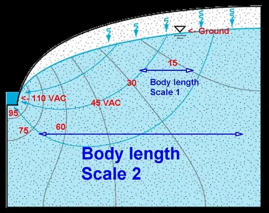

See diagram below:
  • Death a real risk but not a certainty.
    - Potential difference across the water in contact with you is what matters.
    Its potential becomes your potential !!!
  • More conductive water makes things worse.
    (Chlorine, salt chlorinator, ...)
  • Having the water conductive enough tot be BELOW your impedance is worse not better. If the breaker or fuse does not rip then you are shunted across a resistor with voltage on it and your body resistance is higher than its resistance so you don't shunt down the voltage much. If you were in a high imepdance solution you would form a low Z shunt across part of the circuit and most of the voltage drop would occur in the water not in contact with you. ____________
Have a look at the Wikipedia article on conductivity
This translates into the more useful (here) formula
  • Resistance = Resistivity x length / Area
Conductivity = 1 / resistivity
  • So Resistance = length / Area / conductivity
where length is the length of a sample of material and area is the cross section of the sample. This is where your 1/cm figure came from.
What you end up with is a resistor of about constant resistance between the live wire entry point and grounding points, with a voltage drop across the resistance. It's well beyond discussing here, but if you draw "curvilinear squares along the discharge path you can get some idea of the potential that will exist across a length of water in contact with YOU. If this potential is more than about 50V you are liable to be in trouble in a total contact situation.
See the diagram of a "pool" below with curvilinear squares drawn.
There is a 110 VAC contact point and a grounded point - both on a wall in this case.
Voltage contours in this case are as shown. What matters here is "scale".
In the scale 1 case at top the body is small in length compared to the pahse to ground distance and experiences about 1 to 15 Volt potential drop depending on orientation. Anyone floating stretched out along the arrow show would experience an unpleasant sensation but have little chance of dying.
If we rescale the pool so a body is the length of the bottom arrow "there will be trouble" - for a short while anyway :-). An "arrow length" person floating longwise along the arrow length would quite possible suffer ventricular fibrillation before they could stand up AND would probably be above the can't-let-go-limit so could not stand up. Nor cry out possible, nor breath :-(. Worst case (after immediate fibrillation) they may suddenly be paralysed and sink soundlessly and drown. I think that's worth another :-(.
In a pool of increasing size the area available increases with increasing size. The end result is that resistance tends to be somewhat constant as size increases - distance is longer but area increases. (This is where the concepts of amperes per square unit (mentioned in above page) and ohms per square) come from.
So at say 1250 ohm/cm, this would be the face to face resistance across a 1 cm side cube, or a 10 cm per side cube, or a 1 meter or 10 metre per side cube.
In the case of a body falling into a pool all sorts of complications arise. If you were holding the live wire you'd briefly be in trouble,. Then beyond trouble :-(. If the wire fell in a pool you were in then you'd need to know where the ground connections were.
Don't try this at home.
In the real world water will not be pure. In a chlorinated pool conductivity will be affected. And more ... . See electrolytic conductivity
Why does resistance NOT increase with distance as water volume increases?
The "side to side" resistance of a square of water of constant depth with sides of 1mm or 10 mm or 100mm or 1 metre or even 1 kilometre is the same !!!! As the distance goes up by N there are N times as many paths in parallel.
BUT as the size of a cube of water goes up by N the resistance DROPS by a factor of N.
Consider a 1cm per side cube and a 10 cm per side cube.Imagine (to make life easier) that the face to face resistance of the 1 cm sided cube is 1000 ohms.
The 10 x 10 x 10 cube has 10 times the path length so a 1 x 1 x 10 cm path across the cube from face o face would be expected to have a resistance of 10 x 1000 = 10,000 ohms. BUT as the area of th face has risen from 1 x 1 = 1 cm^2 to 10 x 10 = 100 cm^2 cm^2 there are 100 such strips in parallel so the resistance will be 100 times lower than for one strip. So resistance will be.
  • 1000 ohms x 10 / 100 = 100 ohms.
The bigger the cube the lower the resistance.
Resistance decreases linearly with increasing size of sides.
In a pool of constant depth one side of the above "cube" is instead held constant so this reduces the expression from area/volume to area/area and the resistance is constant.
In a pool with you and a live wire and some earth points at unknown locations the situation is confused. You don't know where the ground contact is to the water or "client" and more. so the problem is insoluble as stated. You need a more precise statement to tie things down.

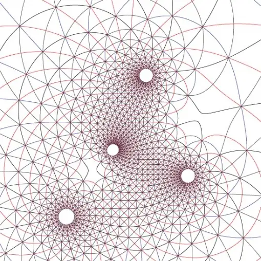

Fun only: Three phase cable in pool, yee ha !!!

  • In the first diagram, is there return path adjacent to the hot? The premise of the other answers is that the adjacent hot and return (neutral and ground) in the power switch keeps the electric field localized. – Michael Pruitt Feb 07 '12 at 02:58
  • @MichaelPruitt - The adjacent return answer is akin to the fallacy that current takes the easiest path to ground. As long as a breaker doesn't blow, voltage will drop between a phase lead and any grounded point elsewhere. You COULD argue for a close earth connection causing a low potential right around the phase lead BUT you can just as easily argue that pahse forms a high voltage area around the ground lead (ie neither is true) and a bit of even quite rough curvilinear square doodling will see you backing away from the pool with your hands in sight. – Russell McMahon Feb 07 '12 at 04:43
  • I actually disagree, as michael said here, as long as you are a distance from the hot and ground lines(unlike something like a bathtub and something falling in) you are going to be somewhat protected by the surge protector being a great distance away. If the surge protector has no fuse other then its power lines it could dissipate enough power for you to feel it, possibly, but that chance is minor as the conductive water is putting such an unbelievably low resistance in parallel to you with something that will be current limited by the resistance of the leads. – Kortuk Feb 08 '12 at 08:49
  • (2) @Kortuk - apparently you disbelieve and or disregard my curvilear squares examples, which are how "potentials" distribute themelves in fields. I'm uncertain where the idfea that there may or will be a surge protector came from, and the suggestion that water has a very low resistance is wrong. While you can achieve low resistance by application of enough ionic material (salt, chlorine etc) plain tap water is quite non conductive and I imagine that many pools would fall in the middle ground. Olin's suggestion that no ground is available is not one I'd like to risk mty life on. – Russell McMahon Feb 08 '12 at 13:11
