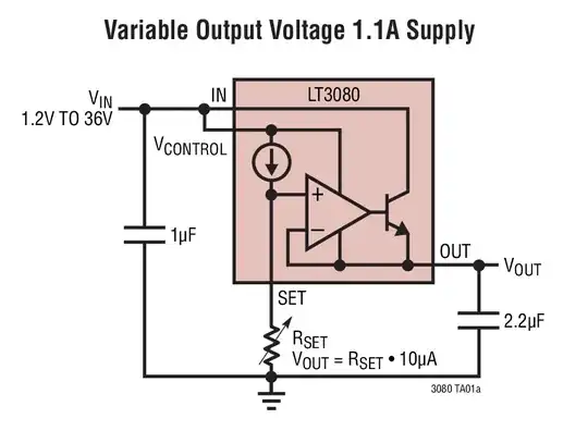

LM317 output voltage can go as low as \$ 1.25\ \mathrm{V}\$, if you want to be able to limit the maximum current with any load connected you must bee able to set the output to \$ 0\ \mathrm{V}\$.
Imagine this case:
you connect a \$1 \ \Omega\$ resistor with maximum current set to \$ 1\ \mathrm{A}\$. In order to keep the output current below \$ 1\ \mathrm{A}\$ your output voltage has to go below \$ 1.25\ \mathrm{V}\$ (which is less than the minimum output voltage of the LM317).
In this situation you cannot maintain current limmiting (without blowing anything up)
I'd suggest using a LT3080. With a shunt resistor measure the output current and use this information to adjust the SET pin.
