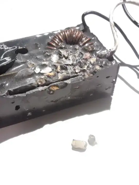

I was recently taking a look at a failed power supply for 12V halogen lighting and noticed an unusual texture in the potting compound. I tried chipping some of it away with a screwdriver and got a nice surprise:
Yes, pebbles. But why? Are they special pebbles or just normal ones?

Thermal conductivity is indeed better for stones than for epoxy. Wikipedia gives 2.8W/(K m²) for granite vs. 0.2W/(K m²) for epoxy. Thermal conductivity can be increased by adding some material, but a potting compound should not be electrically conductive, which prohibits metals, graphite etc. Most insulating casting compound of this kind have a value around 0.8W/(K m²), but I also found a silicone based compound with 5.0W/(K m²).
However, I think the price plays a big role, too. Even normal epoxy costs some money, the heat conductive stuff more, and that 5.0W/(K m²) is for sure very expensive. In contrast, I guess the pebbles in that picture cost less than a cent.

Hypothesis 1 : someone made a good product and wanted to save epoxy by filling as much as possible with junk
Hypothesis 2 : someone made a bad/counterfeit product using less/smaller/lighter components, but wanted it to weigh more

I have heard of using very finely ground silica mixed with epoxy for potting power transformers or power inductors for very strong magnetic fields. Thermal conductivity of this mix should be better than a mixture with pebbles.

The pebbles are filler that also add strength. Potting compound, on its own, isn't really that strong. Just like concrete driveways and sidewalks, you use gravel to fill and build strength while using concrete to fill in the gaps and glue things together. Combined, they make a solid block.

  • If anything, epoxy with pebbles is weaker than a solid epoxy block. I can guarantee you epoxy filled with stones with crack on stone surface rather than in between. – Dmitry Grigoryev Oct 07 '16 at 14:10
  • @DmitryGrigoryev Take a screwdriver and tap it with a hammer on a solid epoxy block and see how easily you can break it in half. Now look at the supplied image in the question and notice the difference. I said epoxy but the question was about potting compound, so I edited my answer. I don't recall if they are always the same thing. It also doesn't take away from the fact that the pebbles are also filler that are cheaper than epoxy. – Rob Oct 07 '16 at 14:33
  • I think sand would be a better bulk filler because it's less likely to damage underlying electronics than dumping a load of gravel on it. –  Oct 07 '16 at 14:41
