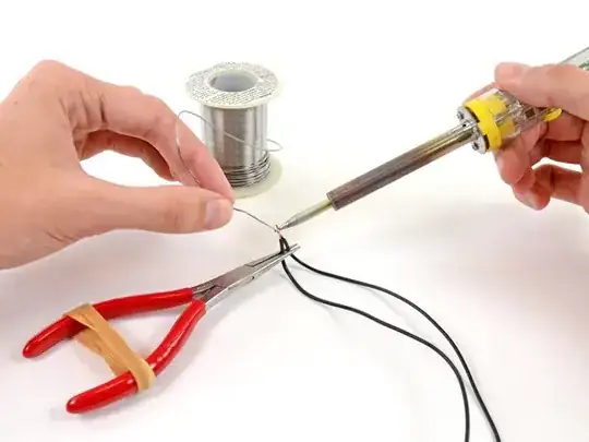

    I keep a supply of Blutack for holding small things while I solder. But for soldering a 3.5mm jack plug Blutack isn't the best because the blutack can soften. A pair of pliers with a rubber band around the handles makes a quick vice. – Steve G Oct 06 '16 at 09:29

38
Figure 1. Image source: iFixit.
This works well for me. Increased grip is possible by increasing the number of "wraps".

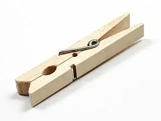

29
A wooden clothes peg (clothes pin in American English) works very well:
clothes peg
it won't suffer from solder drops or brief touches with the iron, and has more friction than many other sprung solutions so is less likely to ping at the wrong moment. You can always rest a book on the handle end to add more weight. If you're equipping a classroom, they cost next to nothing.
I used to keep a couple with my portable iron in a travelling toolkit; the soldering parts of that were mainly for cables/connectors.

    Some other answers are also great, but the peg is quick and cheap solution comparatively to others, and holds my connector perfectly. – h22 Oct 09 '16 at 13:36

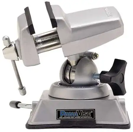

There are tiny plastic vices which are too wimpy for most mechanical work, but are ideal for holding small connectors while soldering. Typically ~ US$5 or less.
And there is the more traditional "Panavise" which is great for larger connectors (like XLR, etc.) There are similar products from other vendors.
