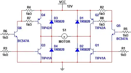

Q1 and Q3 turn ON when you connect +5V to their resistors. Q2 and Q4 turn OFF when you connect +12V to their resistors.
Connecting 5V to R2 or R4 will result in the transistor turning on.
So, if you connect 5V to R3 and less than 12V (or whatever the power supply voltage is) to R4, both transistors turn on creating a short circuit.
If you want to turn off Q2 or Q4, connect their resistors to +12V.
If you want to control the transistors with 5V (a microcontroller or whatever) then you can add two more ttransistors that control Q2 and Q4, like this: modified circuit diagram
Connecting 5V to R6 will turn Q4 on, connecting 5V to R5 will turn Q2 on.

Q4 is turned on by the current from its emitter to base. When you have the emitter at +10V and the base at +5 volts, current will flow, about (10 - 5 + 1.4)/1k or 3.6 mA. This is enough to turn on darlington Q4.

  • I don't understand, why does that mean applying 0 or 5V to R4 will cause the motor to have a lower voltage across it? – Amandeep Grewal Feb 04 '12 at 04:53
    @AmandeepGrewal What Markrages means is that for the low side (Q1 & Q3) you can use 0v and 5v to turn them on and off. But the high side (Q2 & Q4) needs +12v to turn OFF and something less than about 10v to turn ON. Since both 0V and 5V are less than 10v either voltage will result in the same thing: Q4 turning on. With Q4 and Q3 both on, the result is almost a dead short and lots of current flowing. That current is what causes the heat and smoke. –  Feb 04 '12 at 05:41
  • Thanks for that! I now understand the heat issue, and why Q4 turns on with both voltages. – Amandeep Grewal Feb 04 '12 at 06:04
