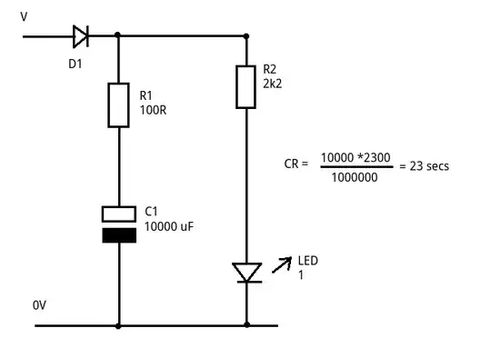

You may want to consider just running the LED from a large capacitor - no extra power supply required.
Values would need to be experimented with (C1 in the region 1000uF - 10000uf) but you should be able to get about a minute and it has the advantage that the circuit automatically dims the led as time goes on - useful in a dark room situation

  • I thought about the single capacitor solution (certainly the simplest! Thanks, J. Dearden!), but I didn't know if I can achieve a consistent one minute timing from a capacitor, and I would probably need to put it together to see if the dimming would be acceptable. It needs to be a clear endpoint, and I don't want interpretation of "when is it really out" to be an issue. I'll have to experiment with that a little. – WayneVT Sep 28 '16 at 21:38

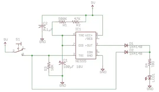

This circuit should do want you want, using a 555 timer:
You should be able to get all the parts at RadioShack.
When the switch is on, the LED is lit via the diode D2. When the switch is turned off, the resistor pulls the trigger line (pin 2) low, causing the 555 to brings its output (pin 3) high for 1 minute, keeping the LED lit via diode D1.
The value of C2 and the two resistors R1 and R2 were calculated here. A value of R of 547K and C of 100 µF gives a delay of 60.17 seconds. Since 547K is not a standard value, I broke R into two resistors, 500K and 47K, both of which are common. Note the actual timing will not be exactly this value, because of the tolerance of the components (in particular C1, since capacitors are often not better than ±10%).
The output can drive up to 200 mA, which is plenty for even a superbright LED.
The value of R4 depends on the LED chosen. The formula is:
$$R4 = {{V_{out} - Vf_{1} - Vf_{2}} \over I}$$
where V\$_{out}\$ is the output voltage of the 555, Vf\$_{1}\$ is the forward voltage of the 1N4148 (1V), Vf\$_{2}\$ is the forward voltage of the LED, and I is the desired current through the LED, for example 20 mA.
The output voltage of the 555 is no where near the power supply voltage. The datasheet doesn't give a spec for the high output voltage for a 9V supply, only 5V and 15V, but interpolating between the two, I estimate it is around 7V. You may want to build the circuit up on a wireless breadboard, with a 300 Ω resistor for a dummy load in place of R4 and the LED, and measure the output voltage first if you have a multimeter.
If the forward voltage of the LED is 2.1V for example, then R can be calculated as:
$$R4 = {{7 - 1 - 2.1} \over .02} = 195 Ω$$
so you could us 220 Ω.
You can run the circuit off of a 9V walwart. Be sure to get a regulated one (see this answer).

  • The 555 solution brought below by T Crosley (Thanks!) looks very promising, and I appreciate the detailed explanation which helps me learn more. The problem with that one is that it has a separate uninterruptible 9V power source to keep the circuit going once the main power source is removed. I'll need to consider whether I can break that out or not. There is a single power source, which is the one going to the main darkroom light that I am tapping into . I'll have to think about that. Can I use an R-C to hold that 9V up for the minute it takes for the timer to time out the circuit? – WayneVT Sep 28 '16 at 21:40
  • @WayneVT I assumed you had a always-on power source for the circuit to operate off of. If you were to use a capacitor (such as a large supercap) to hold the circuit up, unless you added a voltage regulator to produce a steady voltage as the capacitor discharged, the LED is going to dim just like in Jim's solution so you wouldn't need the 555. – tcrosley Sep 28 '16 at 22:00
