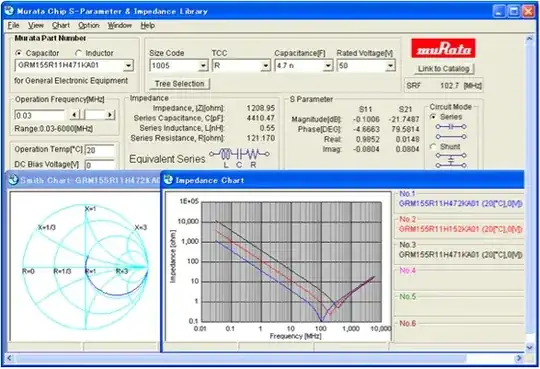

Also, keep in mind that capacitors become inductive at lower frequency than we expect. Here are some typical Murata curves: s param

  • @Singee It depends on the frequency of operation. What is your frequency range? Digital or analog? Digital has high harmonics because the current draw looks like a rect in time domain. A typical 0402 ceramic 100 nF decoupling capacitor self-resonates at around 10MHz. So, above 10Mhz, you should be concerned. It certainly is an overkill for uC, but is absolutely necessary for CPUs, FPGAs, SERDES etc. Look at power supply impedance budgets for your application. Some uC can tolerate a high voltage drop (few V). FPGAs are around 50mV, which is tight. It is a wide and complicated subject, anyway. – user110971 Sep 27 '16 at 17:33
