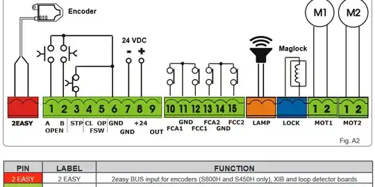

It's marketing speak, as @AndyAka wrote. The datasheet reveals that there's a "2easy" bus connection to which you can connect various safety-related accessories e.g. extra photocells or switches.
I suspect that the "2easy" bus is in reality an AS-i digital industrial serial bus. The bus isn't limited to data, but can carry power to a wide variety of sensors.
