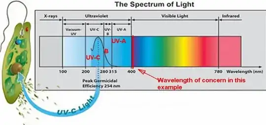

Germicidal lamps which emit short wavelength UV In my workshop I have a ~= 20 Watt UV germicidal lamp - in the form of a "fluorescent tube" BUT with no phosphor so no fluorescence just hard short wavelength UV. This kills germs with abandon and will happily burn the insides of your eyes if you look directly at it for reasonably short periods. eg 1 minute would be far far far too long.

Diagram: Germicidal versus wavelength of interest. Almost
