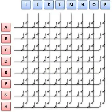

I was trying to construct a 10x10 cross bar switch using relays -- something like:
Question: is it possible to construct this by using solid state components (power transistors?) -- and if it is how would one go about doing it?

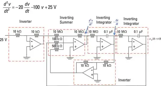

  6. A typical example of circuit that I want to wire together using such a cross bar is below:

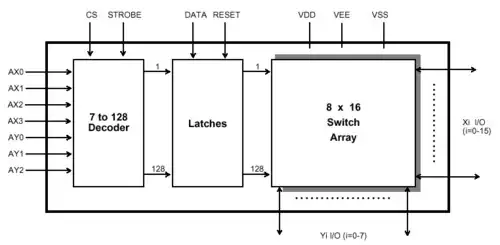

The MT8816 is an analogue cross point switch: -

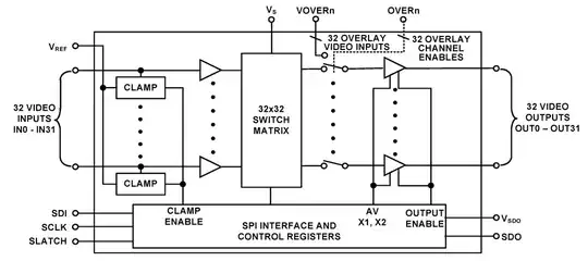

The ISL59532 is a video cross point switch: -

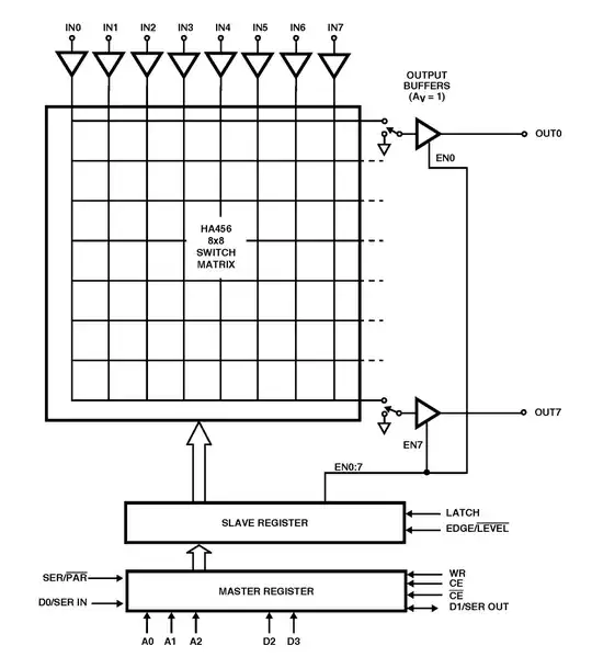

Ditto the HA456: -

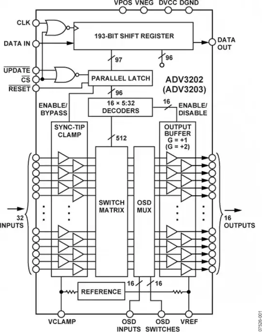

There is also the ADV3202: -
Or, you could just roll your own using analogue switches wired into a matrix.
