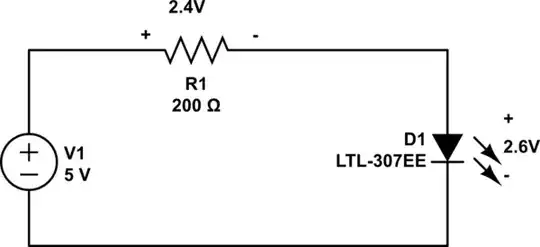

First off, you'll have trouble finding a 5V AA battery, but you could put four AA's in series to get 6V.
When a diode (including an LED) turns on, there is a voltage drop across it.
Let's say that you start with your 5V supply, a resistor, and your LED. When the LED is on, its voltage drop - AKA forward voltage (from the datasheet) could be something like 2.6V, with the positive side at the anode. The voltage drop across your resistor, added with your forward voltage is equal to the supply:
V_supply = V_r + V_LED
therefore,
V_r = 5V - 2.6V = 2.4V
Using Ohm's Law: V=IR, you can find out what current you want to pump through that LED. That will allow you to select your resistance.
Say you want to pump no more than 12mA through that LED, because the datasheet says that over 20mA, and you'll fry it. R = V/I = 2.4V/(0.012A) = 200 Ohms.
schematic
I hope that helps!
