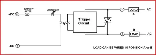

You say you followed Olin's circuit first, but then in the comments you say you tried Russell's circuit. Which one did you use for the relay?
I ask because the two circuits are different. Olin's circuit has the SSR input diode in series with the transistor (i.e. pin3 to V+ and pin 4 to collector) and is driven from the base. Russell's circuit has the input diode in parallel with the transistor (pin 3 to transistor collector and pin 4 to ground) and is driven from the emitter (common base)
Pinout of SSR for reference:
SSR
Assuming your GPIO current capability is really more than 100uA (very likely) then Olin's circuit should work if connected correctly.
One more important question - are you switching AC od DC with the relay?
EDIT - thanks for the schematic. According to that you have it wired incorrectly as suspected. Have a look at Olin's schematic again, notice the SSR is between V+ and transistor collector, not V+ and ground. Make changes as suggested and it should work fine.
