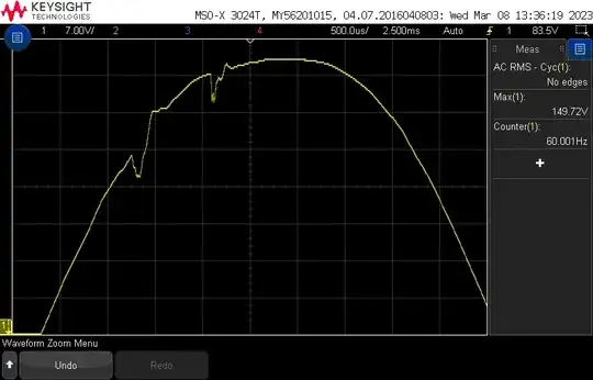

I took some oscilloscope captures of the mains waveform in my house in Houston, Texas. The house is over 50 years old and the wiring is definitely not recent (no grounding). We have LED bulbs on dimmers that weren't designed for them as well as the usual collection of electronics with switching power supplies. This is definitely not ideal!
First, here's a large-scale view of the sine wave with measurements. Normal household outlets have only one phase. I see 110 Vrms with a peak of about 150 V, which is on the low end of the nominal range. Distortions are visible near the high and low peaks.
Large-scale U.S. AC mains waveform
Here's an FFT, which shows third harmonic (180 Hz) distortion at roughly -30 dB relative to the fundamental. The next-largest harmonic is the seventh (420 Hz) at about -45 dB relative to the fundamental. The other harmonics are in the -60 to -70 dB range.
U.S. AC mains FFT
Here's a zoomed-in capture of the distortion, showing variations of perhaps 5V from an ideal sine wave.
Zoomed-in distortion

    Interesting. I'm guessing you have something in the house that has a Thyristor or SCR that's switching on and causing the notches. – Tom Carpenter Sep 07 '16 at 01:30
