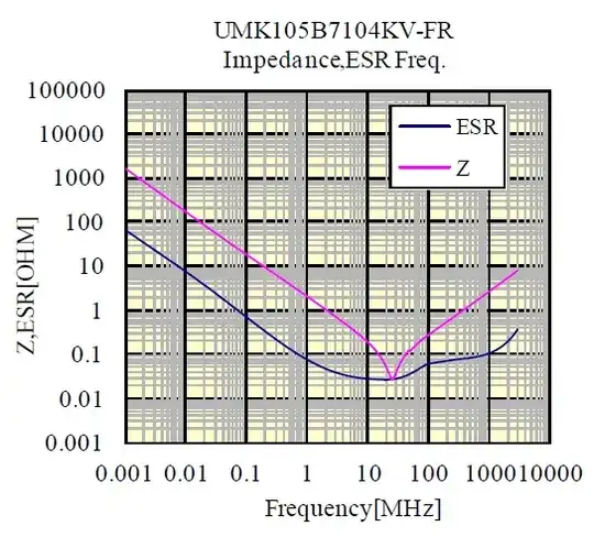

You can look at the datasheets of 100 0402-sized ceramic 0.1 uF capacitors, and the impedance vs frequency curve will mostly all look like this:
The resonant frequency will be somewhere in the 20 - 50 MHz range.
If you look at a 0.01 uF capacitor, still 0402 sized, the capacitive part of the curve (the downward sloping part) will be raised up by one decade, but the inductive part of the curve (the upward sloping part) will be damn near the same as for the 0.1 uF part. There will be only a very small frequency range where the 0.01 uF part provides lower impedance than the 0.1 uF part.
You might think you can do better by trying an 0201 or 010005 size capacitor. And the datasheets will show a slightly higher resonant frequency. But remember that these curves neglect the series inductance added by the traces on the board where you mount the part. Realistically that will become the limiting series inductance as you go to smaller parts, you won't get much improvement in the actual resonant frequency of the part mounted in the circuit.
So what can you do?
Use a 0.1 uF 0402 sized capacitor, place one as near to each power supply pin on your IC as you can. And hope the IC designer has provided adequate on-chip bypass capacitance to deal with frequencies above 200 MHz.

  • I mostly like your answer, but feel there is a disconnect with the capacitors I used to use at GSM frequencies (22/33nf, 0805/0603 if my distant memory serves). Its probably accurate that the package pins are too distant to completely decouple the on chip functions - but I doubt this is a function only of the external capacitor. – Sean Houlihane Sep 03 '16 at 08:22
