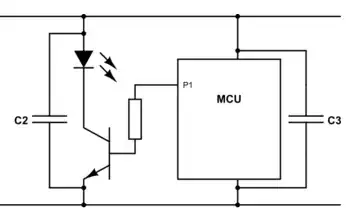

In the answer for this question (Does my circuit need decoupling caps?) there is a transistor between the attiny85 and the led. I understand that if the mcu isn't capable of providing enough current for a sensor, you have to do it the way the schematic shows, instead of controlling it directly trough the mcu. But I think that is not the case. So, why? Is there any advantage?

There are several reasons for using a transistor like that. One is if the load (in this case, the LED) requires more current than a microcontroller I/O pin is capable of providing. Another is if the load is powered by a voltage significantly different from the microcontroller's power supply. Perhaps the microcontroller is powered by a 3.3 volt supply while the load is powered by 12 volts. Another reason could be to isolate the microcontroller from various secondary effects, such as back EMF in the case of an inductive load such as a motor or relay. It can also be useful to isolate relatively high current (but still within the I/O pin capability) but possibly high frequency signals that could cause ground bounce or similar issues, such as when the microcontroller is driving an LED with a high frequency PWM signal.

Taking the context into consideration, he was probably just using a transistor to have something to decouple.

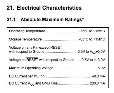

Attiny datasheet states Absolute max current per I/O pin: 40mA, and source/sink capabilities symmetrical.
So, if you're going anywhere over 20~30mA you wouldn't want to drive the load with the MCU (50mA in his example).

In the case of a single visible-light LED and not much else there's no advantage if the MCU can handle the current required. However, if you have many LEDs connected then it may be possible to overload the port or even chip itself, and transistors or even a dedicated driver may be warranted.
