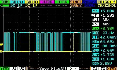

  1. I captured both the PPS and the TX signals on a scope, as suggested in old_timer’s answer
scope trace
The yellow trace is the PPS signal. It's high for about 100 ms every second. The cyan trace is TX. This trace shows the serial data is sent in bursts, with each burst starting shortly after the falling edge of the PPS signal.

A scope should make all of this obvious, put both the serial tx and the 1pps on the scope ideally you see the 1pps leading edge and then after that see the burst of serial messages. That one picture should tell the whole story.
