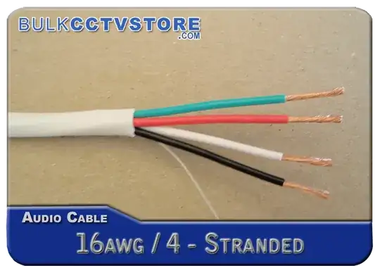

I am using 4 core shielded cable. However, there is a strand of what I assume is nylon running parallel to the conductors. A bit like this
enter image description here (source)
What is it for?

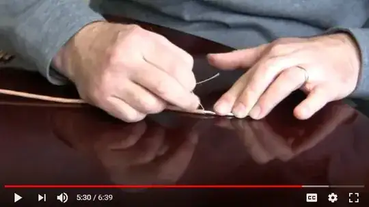

If the thread is just inside the outer jacket (also called a sheath), it is likely a ripcord. It's meant to be used to strip the outer jacket without harming what is directly under that jacket (shield, bundle of conductors, etc.).
This video demonstrates how to use a ripcord. ripcord

That string can be used to strip the jacket off of the cable.
You nick the cable at the end, put the string in the cut, then you can pull the string back and it will cut through the insulation on the way back.
For tough insulation (or soft fingers!) you might want to to tie a loop in the end first.

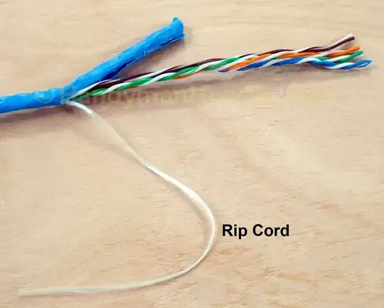

Marker threads (see Andy aka’s excellent answer) tend to be weak.
If it’s a strong nylon thread that’s outside the shield it could be a “ripping cord”. They can be pulled back to slice through the outer insulation. They’re more common in larger cables than the image, but you also see them in UTP:

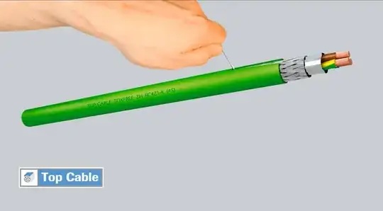

In the case of this question that is a ripcord (source #2).
The company Top Cable has this helpful illustration:
Using a Ripcord
The ripcord allows you to gently tear the outer-sheath allowing you to gently peel it away without damaging the screen. In sheathed wire without shielding screens it's merely a convenience, for screened wire it's important to not damage the screen.

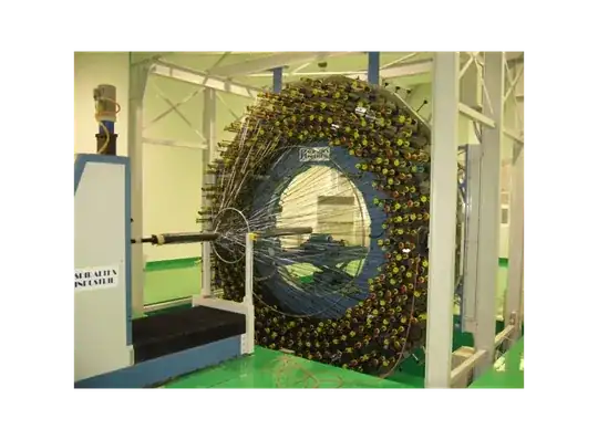

So in addition to being a Ripcord similar such fibers can be used to identify which bobbin a wire or set of wires came from when feeding a cable twister and/or to bind sets of wires together for feeding through the bushings. The purpose of binders is to hold the bundle together until the jacketing operation.
Slider Twister
