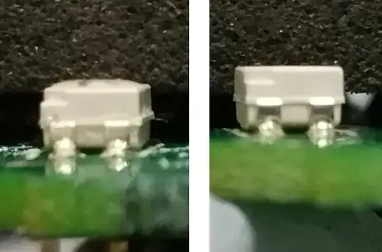

Update 2: I've taken a fresh PCB with LED on it (haven't done any tests yet with just the LED) and soaked it in kerosene. I've taken some close up photographs of the LED before soaking, after soaking while it's not working and after it resumes working after it's been left to dry.
What the photos show is that there is a very obvious bulge in the LED lens during the period when it's not working. Once the bulge recedes, the LED illuminates again.
Unfortunately, I don't have a camera set up on the PCB to see the exact moment that it stops working. I'd let it soak for about an hour before it stopped working. I checked on the LED every now and then and noticed no change in the LED brightness. I came to check it once and it was just off. My suspicion is that the change is sudden.
Judging by the swelling, I'm going to guess that there is some mechanical damage internally that's moving something and once the swelling recedes it springs back to position.
Left: Kerosene-soaked LED; Right: Normal LED Left: Kerosene-soaked LED in failed state; Right: Normal LED
LED in failed state after soaking LED in failed state after soaking
Normal LED Normal LED
Left: Kerosene-soaked LED after being left to dry and in the working condition; Right: Normal LED Left: Kerosene-soaked LED after being left to dry and in the working condition; Right: Normal LED
Kerosene-soaked LED after being left to dry and in the working condition Kerosene-soaked LED after being left to dry and in the working condition

  • I've added some photos showing the physical effects of soaking the LED in kerosene. – Amr Bekhit Aug 19 '16 at 13:40

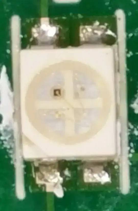

LED picture
e.g. by cutting it off with a razor blade, testing transmission of red light before and after having soaked that material in kerosene.

  • I've added some photos to the question showing how the kerosene causes the LED lens to bulge. – Amr Bekhit Aug 19 '16 at 13:41

    Thanks for your answer. After examining one of the LEDs when it was in its failure state, I couldn't notice anything visibly wrong with it. There was no sign of any clouding or occlusion - the lens seemed perfectly clear. I'm going to try and repeat the test and get some photographs so that I can post them up. – Amr Bekhit Aug 17 '16 at 12:27
  • @AmrBekhit I guess you need a good microscope to see the crucial details if there are any visible at all. – Ariser Aug 18 '16 at 11:51
    Follow up on this, I had a look at the LEDs on two PCBs that I had tested a week or so back and there is very noticeable yellowing of the LED lens. So this reaction with the kerosene you mention seems to be happening. However, I've just updated the question with some photographs showing bulging of the LED lens in the failed state after being soaked. I have a feeling that the problem is mechanical in nature, i.e. the bulging is disconnecting something. – Amr Bekhit Aug 19 '16 at 13:44
