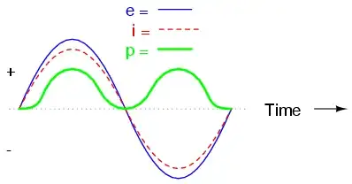

Let's see two graphs representing two circuits, the first is completely resistive and the second is reactive. (source of the images)
resistive circuit reactive circuit
In the first graph, because it is a resistive load, all the power is used, giving us a PF of 1. Why PF is equals to 1? Because the real power (the average of the product of instantaneous voltage and current) is maximum (and thus equal to apparent power) because the signals are always the same (positive and positive or negative and negative). That way, no energy is removed (negative).
In the second graph, because it is a reactive load, all the power is absorbed and then returned to the circuit, giving us an PF of 0. Because the real power (the average of the products of instantaneous voltage and current) is just zero because the signals are shifted and what is lost now is won just ahead.
You see my point? My "theory" is you do not need do anything too fancy (for example, use shiftedV) to calculate the real power, just pick up a large number of pairs of samples and average their product.

Real power is based on the difference in phase between the voltage and the current waveforms. You mainly see it in calculation of power factor. From wikipedia:
The ratio between real power and apparent power in a circuit is called the power factor. It's a practical measure of the efficiency of a power distribution system. For two systems transmitting the same amount of real power, the system with the lower power factor will have higher circulating currents due to energy that returns to the source from energy storage in the load. These higher currents produce higher losses and reduce overall transmission efficiency. A lower power factor circuit will have a higher apparent power and higher losses for the same amount of real power. The power factor is one when the voltage and current are in phase. It is zero when the current leads or lags the voltage by 90 degrees. Power factors are usually stated as "leading" or "lagging" to show the sign of the phase angle of current with respect to voltage.
In your application I believe they are using shiftedV as a way to see how much the phase has changed since the last value. With a purely resistive load, the power factor would be 1...so the real power=apparent power. So you are probably suppose to use a resistive load to determine your phasecal number(set it so real=apparent). Then you can find the power factor for various loads.
Edit: If you take the time average of the instantaneous product of voltage and current, you will surely have a real power measurement. As I (poorly) implied above, I believe the shiftedV is used to adjust for any reactance elements introduced by the measurement process. As a way to null out the effects of the electronics, so you get the real power of the load. Here good reading and pictures National Instruments

  • After reflecting and researching, I think I understand what you're saying (unfortunately I am not an electronics engineer and I'm out of my area of knowledge).
    Probably the transformers and other components, in addition to the ADC itself, constitute a system that inserts some distortion. The attenuation in this case is not critical, but the possible phase shift is. And that shiftedV is correcting just that. I'm thinking correctly?
    The result: I still have to study hard! Anyway, thanks for the help. Certainly worth an up-vote.
    – borges Jan 19 '12 at 20:49
  • I believe you are thinking correctly – Matt Jan 19 '12 at 21:31
