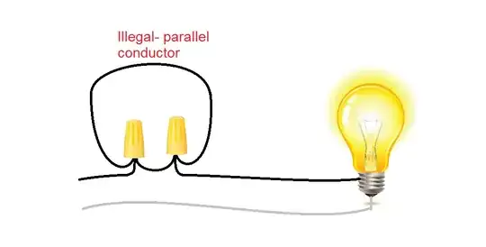

Regarding AC systems (like for homes and such), a circular path is called a parallel conductor. It's illegal (according to the NEC section 310) except under certain circumstances. But I have noticed that with DC circuits, circular conductors are also... taboo (for lack of a better word). See the picture below- just for example (there are probably better examples, so if another example is better for illustrating the problem or answer please, show and tell).
My question(s) is basically, what's wrong with a circular/parallel conductor?
Also, just for clarity, here's a picture of an illegal circuit (per NEC):

Both configurations will conduct power to the loads.
When trying to figure out what's 'illegal', and why, you need to understand what fault conditions the authorities are trying to prevent. There may be a commentary in the relevant standards if you're lucky.
In the UK, such an arrangement of a circular conductor is called a 'Ring Main', and was actively promoted for domestic rewiring from the late 1940s onwards, due to a shortage of copper and high rates of house building following World War II. Having two paths back to the distribution box allows lighter conductors to serve the same area than could be served by spurs.
The rules are that a 2.5mm2 conductor serves an area of up to 1000 sq ft, and has both ends returned to the distribution panel, protected by a 30A fuse. Each socket on the wall that is part of the ring has a loop in and loop out of 2.5mm2, connected at the socket terminals. Note that a spur of 2.5mm2 would use a 22A fuse.
The problem comes if someone replaces a socket without putting both conductors into the terminals, or a conductor breaks somehow. The loop is now broken, and we now have two 2.5mm2 spurs, needing a 22A fuse for protection, but having a 30A fuse, with no apparent failure to alert anybody.
Any paralleling of wires allows this sort of undetectable potential overload error to occur. Some regulatory authorities ban the practice, some permit it.

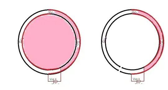

Let me show you one of the possible paths a current can take when the upper diode is switched on: enter image description here Here, red lines represent current path, and ugly pink covers the area which will radiate the EMI.
If the resistances of wires forming the loop are unbalanced (this is often the case, especially at high frequencies), the loopy schematic has the potential to form huge loop antennas, which will radiate orders of magnitude more interference than conductors which guarantee current paths are close together.

    There's just one minor nitpick with your answer. It shows a ring circuit which is in all respects DC and driving non-EMI-generating loads. DC doesn't have this problem. – Harper - Reinstate Monica Aug 08 '16 at 20:20
  • @Harper really? So if it's a purely DC system, then it would still make this loop magnetic, yes? It's EM but no EMI- because it doesn't oscillate? – Ben Welborn Aug 08 '16 at 21:23
    @BenWelborn The loop is an inductor. Inductors resist changes in current. No change, no resistance, no heat. There's a static magnetic field there, but then, the same is true of a refrigerator magnet. Those don't get hot. – Harper - Reinstate Monica Aug 08 '16 at 21:55
    Yes, I should be clear -- what NFPA cares about in Dmitri's answer is the magnetic fields in that red area causing inductive heating and doing damage / starting a fire. Yes, you are right that the DC magnetic field will influence ferrous materials. In fact that's used in saturable core transformers to dampen AC power flow through the transformer by a DC winding, or even multiple DC windings adding or canceling. – Harper - Reinstate Monica Aug 09 '16 at 04:02

    Actually, I would hesitate to say that the wiring in figure #2 of the OP would be legal in any jurisdiction (without provisions). Parallel conductors are legal in USA provided that the wires are the same length, have the same shielding, are the same diameter (minimum diameter - 1/0), and are connected with the same terminals. Although ring systems are legal in UK, they are not willy nilly. I'm not familiar with BS 7671 (the Brittish Regs) but I would doubt that the wiring shown in figure #2 would be okay there (but please prove otherwise if possible). – Ben Welborn Aug 08 '16 at 23:47

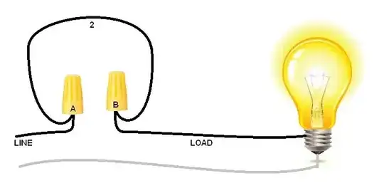

Concerning the circuit in your second figure, if every wire in the diagram is big enough to safely carry the full current demanded by the load, then the circuit poses no fire or overload hazard.
Consider this circuit (1):
circuit 1
Where wire 1 is adequate to light the lamp without overheating.
Consider separately this circuit (2):
circuit 2
Where wire 2 is also adequate to light the lamp without a problem.
Now, starting with circuit 2, add the wire from circuit 1:
circuits 1 and 2 simultaneously
What happens to the current in wire 2?
The current in wire 2 cannot increase, because no additional path is added between LINE and A, nor any between B and LOAD. In fact, the current will decrease, although it is not likely that it will decrease by half, unless the resistance of the two wires accidentally matches.
Now, starting with circuit 1, add the wire from circuit 2. What happens to the current in wire 1? It will decrease, although -- again -- it is not likely that it will decrease by half.
All the current required by the load will divide between wires 1 and 2, depending on their comparative resistance, but neither wire will be called upon to carry more than all the current. Since either wire can safely carry all the current, there is no overload hazard.
As another thought experiment, begin with both wires connected, and gradually increase the resistance of wire 2. What happens to the current in wire 1? It gradually approaches, but never exceeds, the full load current. Increase the resistance of wire 2 to infinity, by cutting or removing it, and the current in wire 1 reaches exactly the full load current.
As long as the condition holds that either wire 1 or wire 2 can safely supply the load, there is no combination of asymmetrical resistance that will result in a current overload in any part of the circuit. This is why the circuit in your figure 2 does not pose an overheating hazard.
