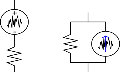

Either thermal noise or shot noise can be characterized as either a voltage noise or a current noise, based on the Thevenin and Norton equivalent circuits:
Thevenin and Norton equivalent noise sources
In any case the resistor noise is injected into the circuit nodes connected to the resistor. Because it is generally a very low level signal, it's unlikely to be emitted as EMI and cause problems in unconnected parts of your circuit, unless, of course, your circuit is amplifying it.
