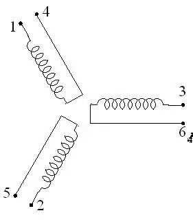

Here is a simplified 3P electric motor below:
3P motor
This motor is simply combined of three coils facing toward to the rotator (in the center) 120 degree apart to each other.
The user wants his rotator to rotate (real work expected from the motor). Rotation force comes from the magnetic flux. And magnetic flux comes from the current flowing through the coils. So magnetic flux has nothing to do with voltage, only current is its concern. Am I right so far?

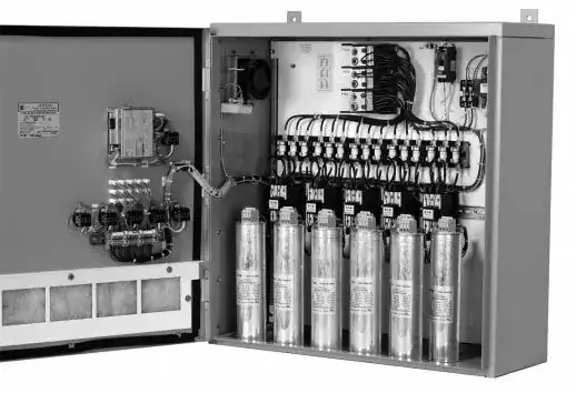

In industrial applications a bank of power-factor capacitors is typically installed at the main distribution panel. A controller monitors the incoming voltage and current, calculates the power-factor and switches in contactors to connect the capacitors across the supply. Since most industrial premises are three-phase the capacitors are supplied in delta configuration inside a three-terminal metal case.
Figure 2. An industrial power-factor correction bank with controller (mounted on door), fuses, contactors (relays) and capacitors. Source: Direct Industry.
