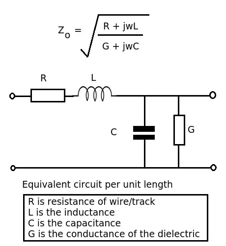

When you look at any half decent transmission-line (like coax or properly designed copper tracks on a PCB) it has a characteristic impedance and this can be mathematically modelled as a bunch of short sections like these: -

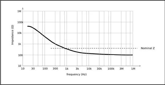

At low frequencies, R and C dominate and you get capacitive problems. For instance, on telecom lines the impedance isn't 600 ohm across the speech spectrum but more like this at audio: -
At much higher frequencies this settles down to be 100 ohms in the above example but on many coax cables it is 50 ohms or 75 ohms. Note that in the above picture nominal impedance (600 ohm) is shown with the dotted line and roughly corresponds to the impedance at 1 kHz.
So, getting back to the point, the edge transitions in your signal are very fast and these will be transmitted at a part of the spectrum that is at least 1 MHz or above and therefore the characteristic impedance equation (shown above) boils down to \$\sqrt{\dfrac{L}{C}}\$ i.e. purely resistive.
This means, unless you have what might be descibed as really crappy cable (or badly designed connections on your PCB), the edges of your digital signal will not be low pass filtered as such.

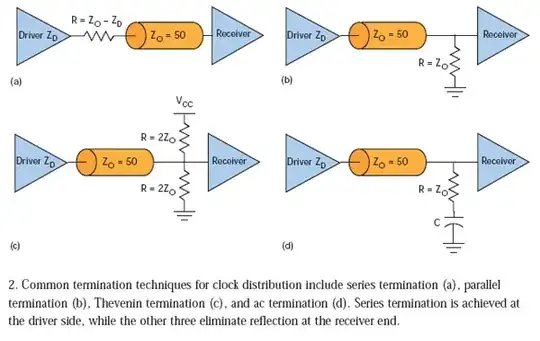

Given also that if you don't treat cables and tracks as transmission lines you will see strange phenomena in your signal that may look like capacitive effects. I'm talking about signal reflections from a badly terminated transmission line. All of these are good methods in there own ways: -
If you don't make an attempt at terminating the line in one of the methods above you will likely get reflections bouncing back and forth and it may look like this is caused by too much t-line capacitance.
