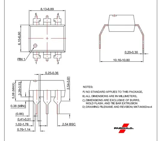

Should I use a 2.75mm pin pitch for this Fairchild MOC3023TVM, or should I stick with 2.54mm(100mil) spacing? Notice the alignment on the dimensions from the datasheet in the figure below (2.75mm = Center to Edge + 1/2 Pin Width):
Fairchild Wide DIP-6

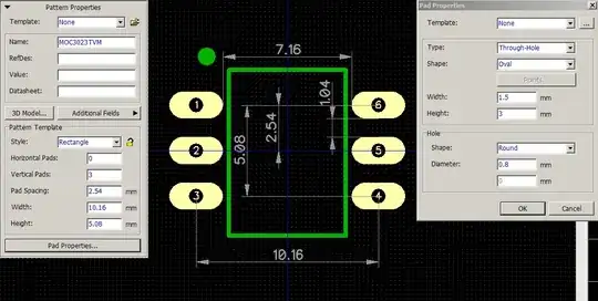

I've put together some nice PCBs in the past, but mostly with SMDs. And always with the luxury of recommended/standard patterns. What hole/pad size would you use if you were making a custom pattern for this part? I was thinking 0.9mm/1.8mm, which I derived from here. It's the PCB fab I was thinking of using for this project [Sorry OSHPark, I'll be back! :)]

EDIT-OK, so here is the pattern I'm going with for the first/proto spin. I'll make another edit once I build it up. Thanks everyone for your help!
Pattern for first run
    The "C" in "BSC" means "center"; this drawing does not even make sense. You'd have to ask Fairchild. – CL. Jul 22 '16 at 08:14
  • @CL thanks, found this: "BSC means 'Basic Spacing Between Centers'" -stevenvh link. Back to the (cad)drawing board :( – Boone Angel Jul 22 '16 at 11:33
From the dimensions given in the diagram, we can see that the pins are at most 0.51mm x 0.3mm in cross section (using the upper bound for each). Pythagoras says that this corresponds to a hypotenuse of 0.6mm - which also corresponds to the diameter of a circumscribed circle, and hence the absolute minimum drill size.
You need to also allow for plating thickness within the hole. Lets say that brings up the minimum to 0.8mm. Your specified 0.9mm hole should be plenty large enough.
In terms of annulus, the minimum annular ring dimensions will be specified by the PCB fab company. So anything larger than that but small enough to meet the minimum spacing between pads should suffice. 1.8mm would leave 0.95mm between pads, which is plenty sufficient for all modern fabs. You could make the holes smaller, or even go with an elongated pad shape if you want to be able to route traces between the pads. If you don't need to do that, 1.8mm should be fine.
Depending on the voltage (just looked and seen the spec goes up to several hundred volts), I'd be tempted to err on the side of caution and keep the pads smaller - maybe go for 1.5mm or perhaps smaller, or make them elongated. This will increase the clearance between the pads and so reduce the likelihood of arcing between them, especially when the triac is turned off.
As for the pad spacing, that datasheet is really unhelpful, it seems to suggest the spacing will be anywhere from about 2.5mm to about 2.9mm. I would as you have suggested go somewhere in the middle - given this is not going in an IC socket, you have the flexibility to choose. 2.75mm would be fine - the pins given how small they are should easily bend to fit in the hole, and given that a 0.9mm hole is about 0.2mm oversize allowing for plating anyway, you shouldn't have any issue getting the part in the hole.
You could increase the hole size further if you want a nice easy fit - 1.1mm or so would be reasonable and give you plenty of slack with the range of the spacing.

  • You neglected to answer the main question - the non-standard spacing between the pins. It is not 2.54 mm between the center of the pins. – pipe Jul 22 '16 at 01:48
  • @pipe so it's not, didn't see that. But if its a PCB footprint, that isn't relevant to the hole/pad size. Still though, yeah, that's just an odd package, really odd. Never mind, just seen the first bit of the question. – Tom Carpenter Jul 22 '16 at 01:49
  • Thanks, Tom! No, I'm using this for isolation, so no traces through/around the pads. Good point though; I may still use elliptical pads anyway, just to be on the safe side. – Boone Angel Jul 22 '16 at 01:50
  • @Tom Any wisdom on the pin pitch? – Boone Angel Jul 22 '16 at 01:51
  • @BooneAngel see my edit. Basically you should be ok with 2.75mm. – Tom Carpenter Jul 22 '16 at 02:00
I think I would use 0.8/1.4 pads with 2.77mm pitch. >10mils annular ring should be enough.
If voltage clearances allow, increase the pad size a bit, 1.5 or 1.6 mm maybe to increase repairability.
