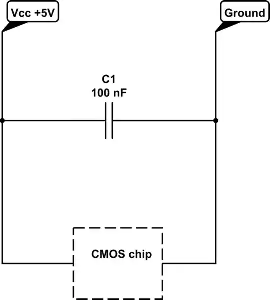

I am studying digital electronics. A book says that "use a 0.1 μF capacitor between Vcc and ground for each IC".
What does this mean?
Why can a capacitor protect CMOS chips?
Does it mean that a capacitor should be added like in the figure?
update (7/21/2016): okay, maybe I was confused with the meaning. A chapter of the book was talking about static protection for CMOS chips and for an experiment it mentioned the quotation with a footnote. The footnote says, "In keeping with standard practice, capacitors are specified, particularly with CMOS devices, to return switching current 'spikes' to the source through the shortest possible path"
So, I thought a capacitor should be used to "PROTECT" CMOS chips.

That's not a protection device, if you intend "protection" as something that prevents the chip to die, but it serves as a so-called bypass capacitor.
It acts as a reservoir of energy whenever the chip draws pulses of current when switching occurs. If the power rails were truly ideal connections, with no resistance nor inductance, bypass caps wouldn't be necessary.
Since the rails have some resistance, whenever the chip absorbs a sudden pulse of current, a corresponding voltage drop develops along the rail, risking to bring the rail voltage out of specs. The bypass capacitor reduces this risk in a way similar a filter capacitor after a bridge rectifier reduces the ripple of a rectified voltage.
In other words, bypass caps help keep the voltage of the power rail constant at the chip terminals, which is what is needed for its correct operation.
Note that bypass caps need to be placed near the IC they are meant to "protect", in order to be effective. Here "near" means that between the terminals of the cap and those of the chip there must be the least distance possible along the copper traces, in order to minimize the resistance (and the inductance as well) that is not bypassed.
Dave Jones, of EEVblog fame, has made a nice tutorial about bypass capacitors (EEVblog #859).

  • Thank you very much, Lorenzo. It helps a lot for me to understand my question. So if a proper capacitor is used to each COMS chip, it protects the chips. or at least capacitors help CMOS chips work properly. As mentioned in the update, the textbook was talking about static damage in CMOS devices. So I thought a capacitor can be a protection part for a CMOS chip. Do I understand correctly? – Heigenberg HP Jul 21 '16 at 21:36
  • @HeigenbergHP I find very strange the terminology the book is using. You mention "static protection". Do the book use really that exact expression? Usually when we use the term "static" and "protection" in the same sentence, especially in the context of CMOS devices, we mean something related to Electro-Static Discharge (ESD) protection of CMOS inputs, which is usually accomplished (in modern devices) through internal protection diodes connected from the input pin to the rails. Bypass capacitors have little to do with ESD protection. – LorenzoDonati4Ukraine-OnStrike Jul 21 '16 at 22:29
  • probably that's why I was so confused. here's the textbook says " the circuits constructed in this experiment use COMS logic. You should use static protection to prevent damage to your ICs" – Heigenberg HP Jul 21 '16 at 22:57
  • @HeigenbergHP Modern CMOS ICs, even of the now "ancient" 4000 series, have embedded ESD protection circuitry, so it is usually not necessary to use particular precautions handling them, especially if you are just toying around with them in a didactic lab. Just avoid touching their terminals if the room humidity is very low and you tend to generate "sparks" due to synthetic/woolen clothes, just to be on the safe side. – LorenzoDonati4Ukraine-OnStrike Jul 21 '16 at 23:07
  • @HeigenbergHP, of course, since ESD events can degrade permanently the performance of a chip, in an industrial/professional environment, where reliability is paramount, you would wear an antistatic wristband connected to earth ground to avoid any potential issue. – LorenzoDonati4Ukraine-OnStrike Jul 21 '16 at 23:09
  • Now I understand. ESD protection and bypass capacitors are different. I think this post should not be deleted for future dummies like me. The book used the two terms on a page. it was so confusing. – Heigenberg HP Jul 21 '16 at 23:15
  • @HeigenbergHP Don't worry! It won't be deleted. Marking a post as a duplicate is not a mark of shame! It is the way a network of related question is built here on EE.SE and in all SE sites. If your question were so bad, it would have been downvoted to oblivion and closed for being off-topic or something like that. As it stands it shows research effort and willingness to understand. So that's good. – LorenzoDonati4Ukraine-OnStrike Jul 21 '16 at 23:18
