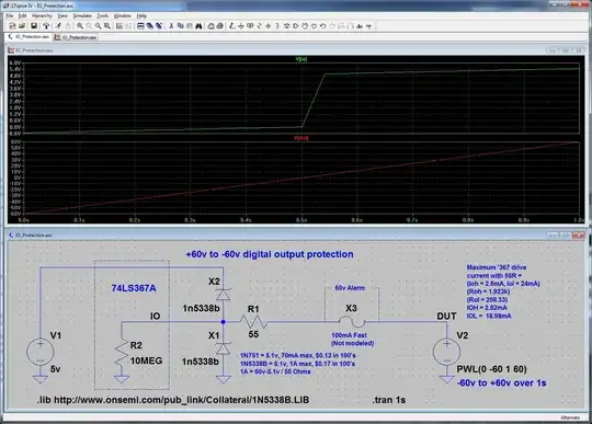

If whatever these outputs are driving is normally fairly high-impedance, then the following might work to clamp +60v to -60v. Fuse is not modeled. This does reduce the drive current slightly, and the 1N5338B's also introduce some small amount of capacitance (not specified in the datasheet) which will slow down fast transitions slightly.
I/O Protecton
Note that this will dump up to 1A per pin into the 5V supply if fuses are not used (which would be ludicrous.) Place a 60v-capable alarm across the fuse, and that can indicate a fault. A PTC Polyfuse may be an option, however they have on-state resistance, a higher resistance after tripping, and limited power-handling capability.
