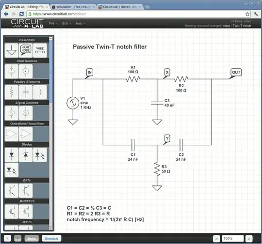

CircuitLab is a beautiful in-browser circuit simulator that was launched a few days ago by a pair of MIT students. I think electronics.SE is going to love it! It does full mixed-signal analysis and appears quite capable. I look forward to seeing where it goes!
Here's a screenshot:
CircuitLab screenshot
You can share circuits via convenient short URL's. For instance, here is the circuit shown in the schematic: http://circuitlab.com/circuit/fq7c97
