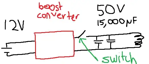

I'm having a little trouble finding a way to activate my circuit. I don't have a proper circuit drawing tool available however hopefully my drawing from MS Paint will do.
EDIT: Switch should be between capacitor and solenoid, not between boost converter and capacitor.
I have a 12 VDC power supply, that goes through a boost converter, and charges capacitors of 15000 uF combined to 50 V. When I activated my physical switch in the past (with lower voltages), the current would flow from the capacitors and power my solenoid (linear kicker). However, ever since I raised the voltage up to 50 V, my physical switch breaks down (blew up...) and is unable to handle the higher voltages.
I don't have a very good understanding of transistors, but I want to be able to activate this circuit through a 5v input current (from an Arduino).
I have seen a couple transistors, however I am unsure whether it is capable of handling these high voltages, and high currents (i = C*dv/dt) (I don't know di/dt), nor do I know how to hook the circuit up.... I am very scared of linking a 50V circuit to the Arduino... Or do I need a relay instead of a transistor?

    I don't have a proper circuit drawing tool available Actually you do ! Edit your question and use the circuit editor, it is activated with the small resistor/capacitor icon (or press Ctrl M). – Bimpelrekkie Jul 11 '16 at 10:18
  • Oh indeed! However I do not exactly know how to draw up the circuit for the boost converter or the solenoid... – V. Kuo Jul 11 '16 at 10:20
  • The switch operates at 50 V, it is difficult and cumbersome to use a transistor to switch like this from an Arduino. I suggest you use a relay or a solid state relay, see: https://en.wikipedia.org/wiki/Solid-state_relay Do get a solid state relay which can handle DC at switching side (many only work with AC). – Bimpelrekkie Jul 11 '16 at 10:22
  • The boost converter circuit is irrelevant. 50 V comes out, that is enough. – Bimpelrekkie Jul 11 '16 at 10:23

  • If you replace the MS pain circuit with a proper schematic and ping me, I'll remove my downvote. – skrrgwasme Jul 11 '16 at 17:03
Your drawing does not match your description. You say the boost converter charge up the capacitors, then you activate your switch. If the switch is open and located as you've drawn, then there is no way the boost converter could charge anything.
Also, as you've drawn your circuit, the solenoid would always be connected to the capacitors, so I don't see how the capacitors would ever become charged, you'd just be shorting the boost converter through your solenoid with the caps in parallel.
Please draw an accurate picture if you're going to draw one at all. As it stands now, it would actually have been better without a picture, as the one you've drawn is wrong and just confuses things.
I'm assuming you meant to draw the switch between the capacitors and the solenoid, not between the capacitors+solenoid (permanently tied to each other) and the boost converter. In other words, the switch causes the capacitors to dump their stored energy into the solenoid when closed.
