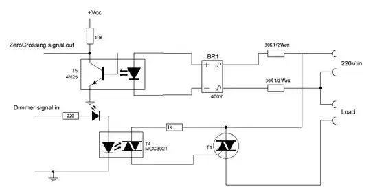

I want to build a 8 channel, independently controlled AC dimmer using Arduino. I have successfully tested a single channel dimmer but i am stuck in expanding it to 8 channels. The circuit I am referring is as below single channel dimmer circuit
The arduino code i am using is as below

Any ideas about how can i expand the code and circuit to work with 8 channels that can be INDEPENDENTLY controlled ?

  • Your diagram and code snippet for only one channel, if you ask your problem exactly then answer will be more closure to solution ! – Photon001 Jul 07 '16 at 13:32

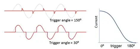

Figure 1. Relationship between current and trigger angle.
Note that the current produced does not vary linearly with the trigger angle due to the sinusoidal mains voltage waveform. Small changes around the peak voltage will have more significant effect than closer to the zero-cross. You may want to address this in your code if the visual effect does not match your dimmer setting.
