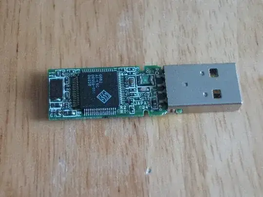

I'm looking to build a USB device that plugs directly into a mini USB OTG port - similar to those USB flash drives that can plug directly into smartphones with OTG-enabled micro USB ports.
I was thinking that the easiest way to build something like that is to have the connector soldered directly onto the PCB board - similar to how existing USB flash drives do it.
However, I'm not able to find a single supplier that sells PCB mounted male mini USB connectors. All my searches either come up with the female connector or a PCB mounted USB-A connector. The few I have found (from one supplier in China) aren't the USB OTG rounded type (although they would work).
Is there a reason why this is the case? Is it simply because it's not a commonly used part or am I simply not using the right search terms?

What you show in the picture is a standard USB 2.0 connector, not a mini. Are you looking for a Mini USB Type B? They are available, but unless you are looking for a "program" volume, you will find it hard to get the attention of any of the manufacturer's.
My company still manufacturers these and you can check out the SMT mounted version at AVX. If you have a low volume need, contacting distribution would be the way to go.
