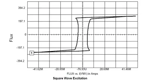

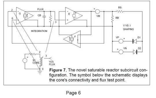

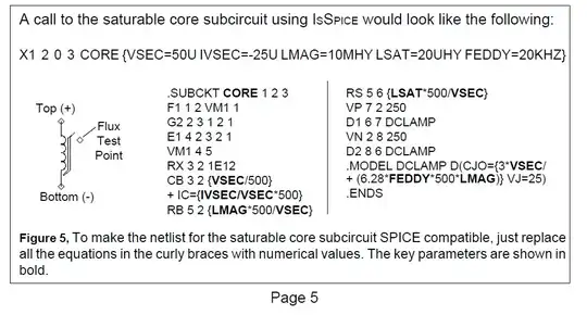

I found a great article at this site to model transformers. It explains
"The work of Hsu, Middlebrook and Cuk 2 develops the relationship of leakage inductance, showing that relatively simple measurements of input inductance with shorted outputs yield the necessary model information."
They developed this for IsSpice, but it could be applied anywhere. Here is the spice code for a saturable core (just in case the link goes down) enter image description here Here is an included picture of the model enter image description here This is a graph of a modeled core: enter image description here
